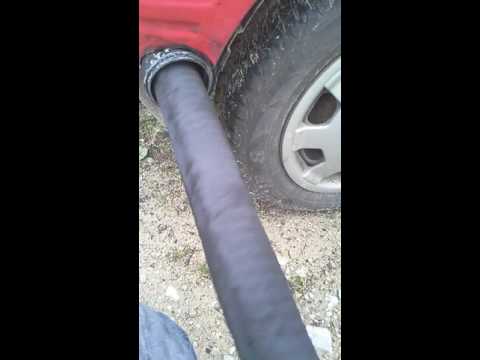

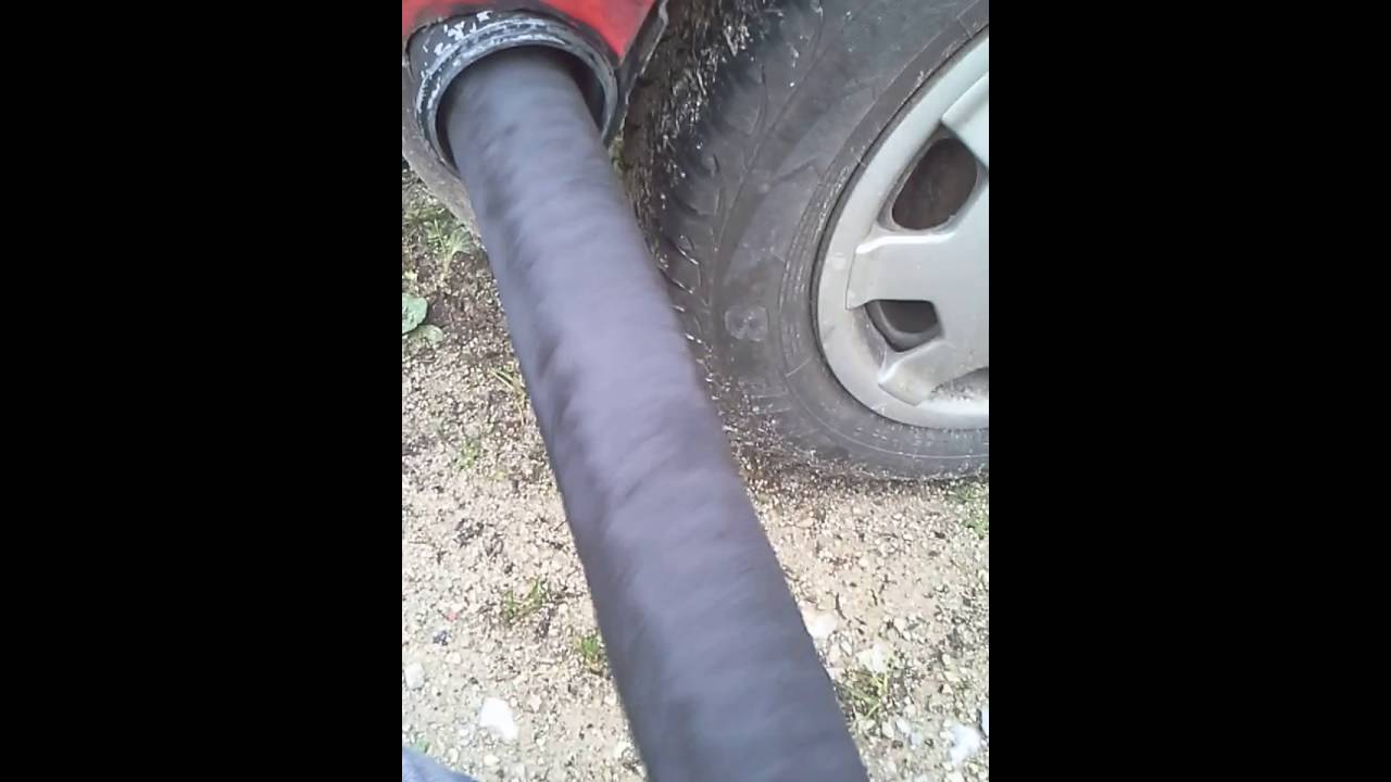

I don’t want to sound pushy but (borrowed that line from someone else) would it be possible to get a glimpse of your Seat in a refuling/lightup/driveing-video? I’m sure it would be very much appreciatied by everyone. If you don’t want to, that’s OK.
Went backpacking by rail through Europe in my youth in the 80s. Went through your area, Yugoslavia at that time. It would be very interesting to see what it looks like now.
I have it all on tape but my computer dyed so i cant upload. If someone culd tell my how can l upload by smart phone l wuld be so thankfull!
As for your request to show you how it looks like here l have a better idea. The railroad is still functional here so perhaps you culd just get your self a backpack and come to see it in person again. I wuld love to finaly meet someone who is in gasification. I am most likely the only one in this piace of earth
Open a youtube-account and upload there. That’s the only way, pc or phone. Then you just copy the link and post on DOW.
