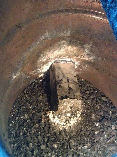

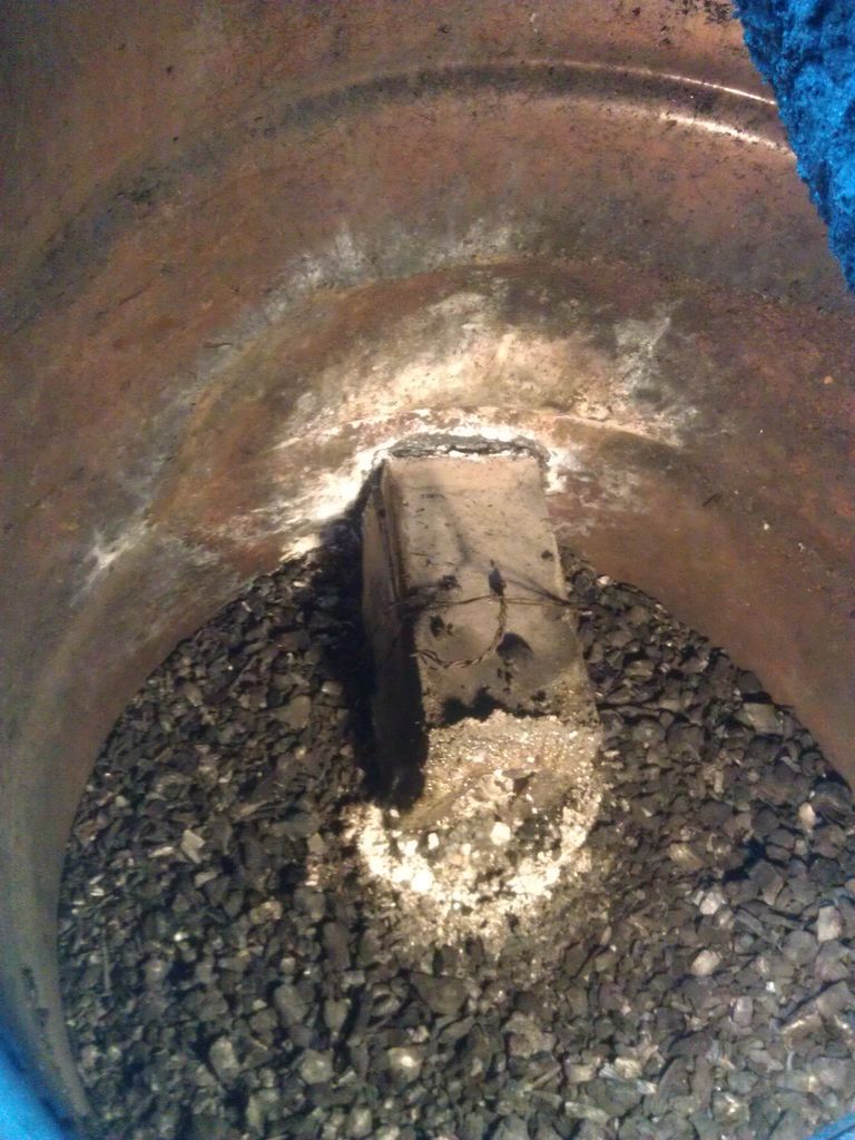

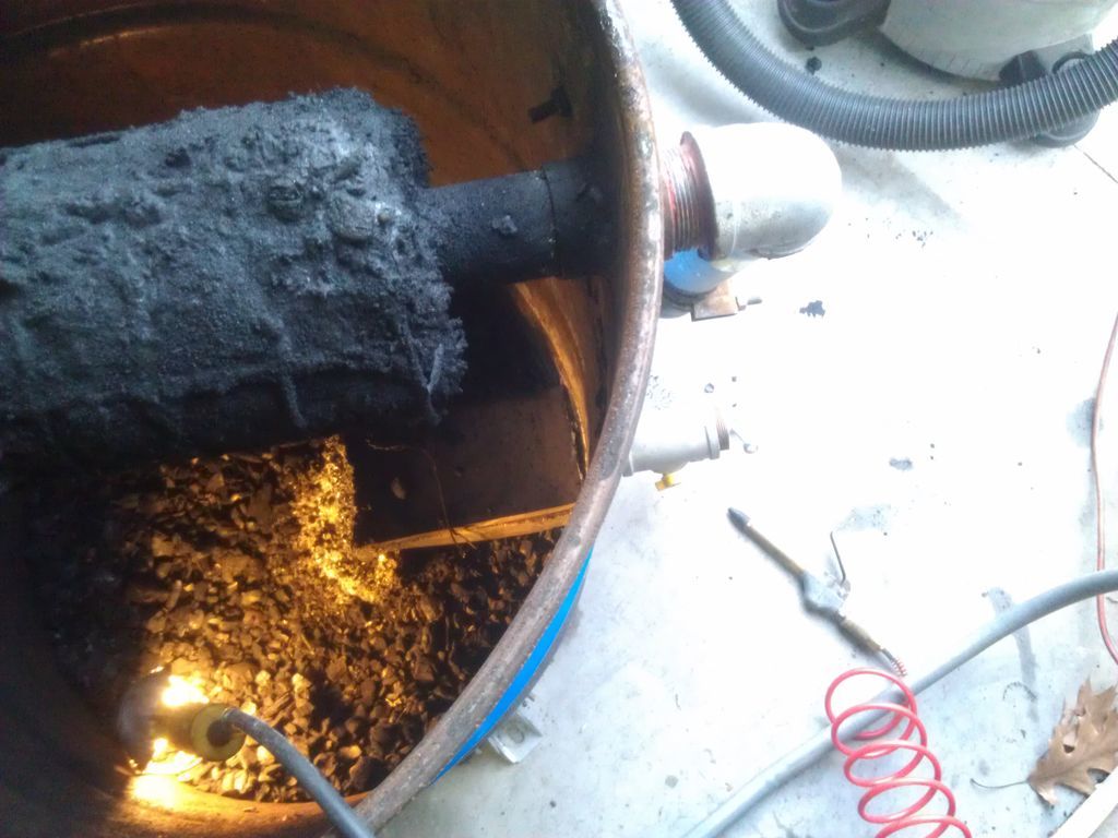

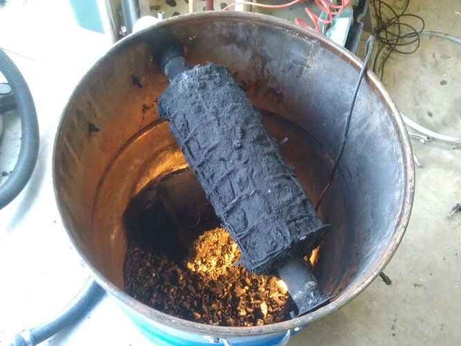

Hi guys,
Today I got the gasifier emptied out and got some good pictures of the firebrick hearth. It’s amazingly intact for the heat I put to it. The first picture shows a top view of the gasifier with (a very dirty) fiberglass-insulation filter. Second, a view of the “firebrick box” stuck to the inside of the barrel. This is just glued into place with silicone RTV, most of which has deteriorated. The third shot shows both the inside and outside of the barrel, how the intake fitting lines up with the hearth.
