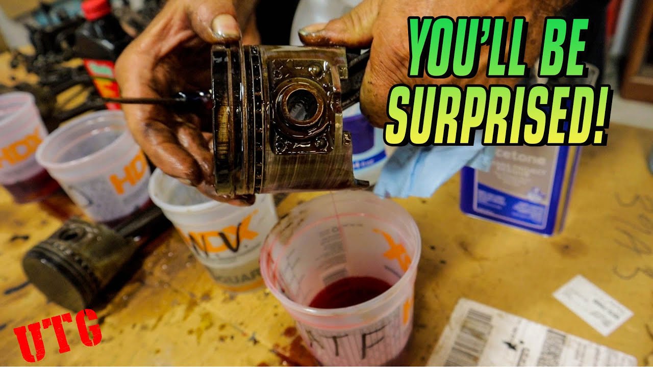

I don’t know if this will help, Bill. Interesting anyway.
Nice video, but not relevant to cleaning crudded up carburetors or throttle bodies.

I would have bet before hand with the video set up on the white vinegar. No way in hell I am putting that down an engine throat!!
