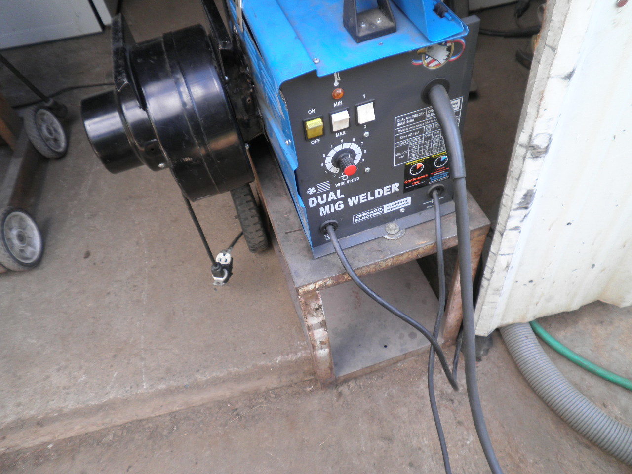

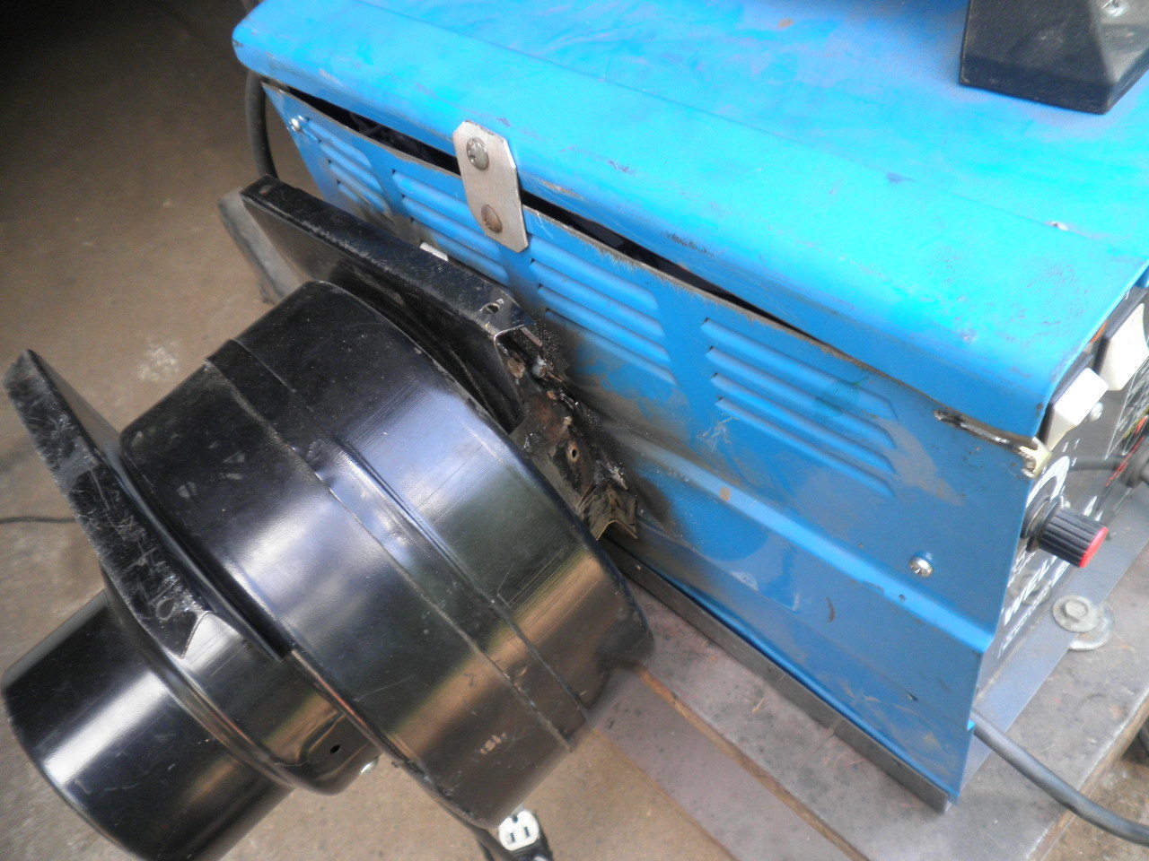

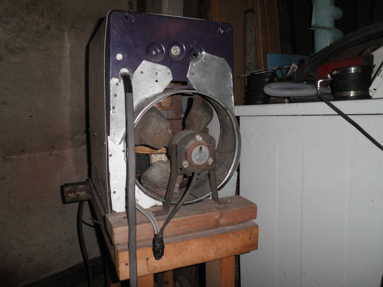

my mig is a cheap dual mig welder from harber freight or chicargo electric, gas or gasless,it barely welds without poping,with a small duty cycle att 70 amps untill i put the external fan on it now i can weld 14 gauge ,9 feet at a time before i am tired,so i let it cool down ,then while checking the heat on transformers, the heat is under 87 F so far, this welder is junk but it holds a much better dutty cycle with the big draw fan,it has no time too heat up.I havent tested heat on the diode, the heat sink is under 85 f , through the back panel with infered temp gauge.
My vote is Eastwood Welders.

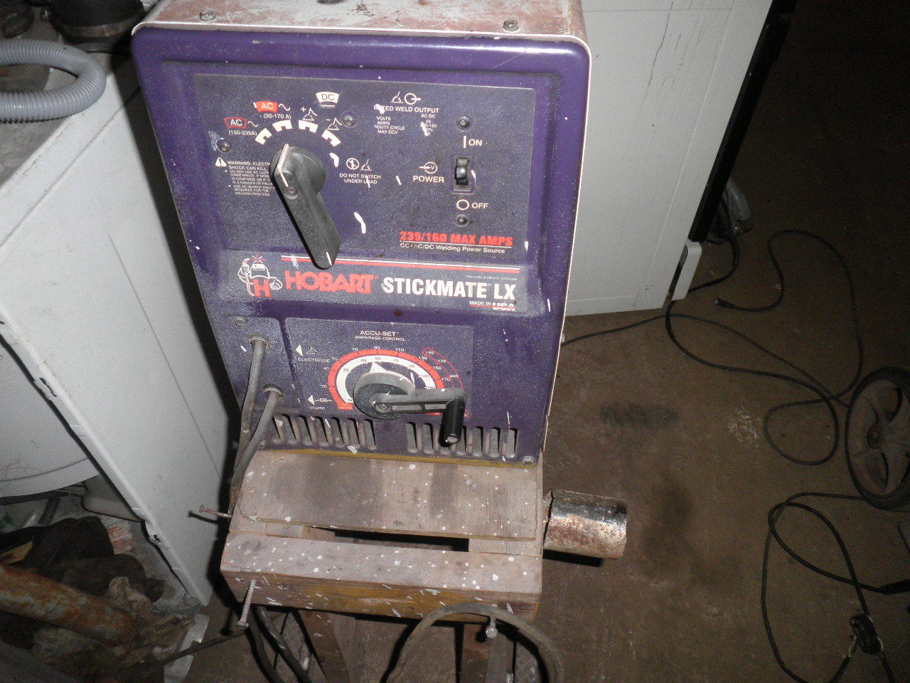

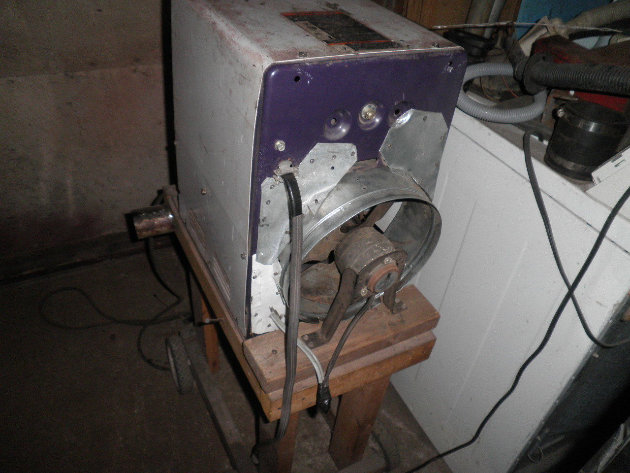

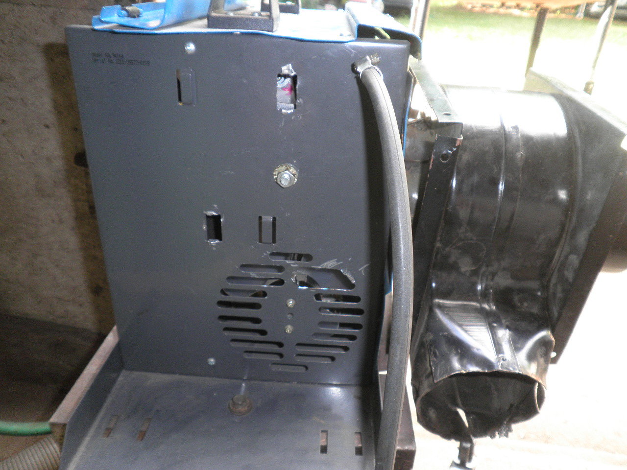

Hi Joseph hauler I would not buy a chicargo electric welder pop corn poper either.since i have this welder i am giveing it a good work out with the real cooling fan,most of them small welders dont have a big enough fan in the first place ,it makes for more sales after the sale, is my 2 cents on welders.i would not give a hole lot of money for any of the non comerceil welders that i have seen,most are under cooled and over rated.GOOD LUCK WITH YOUR WELDER THOUGH.SO far i have been running it at max 1 witch it is rated for 30 percent duty, though with the big at least 2.5 amp fan it has run out about 6 pounds of wire at nearly 100 percent duty and staying below 90F on diode heat sink and transformer that it is useing too weld. is the only reason i am posting this cooling factors. PS the fan will be in the back panel and be more like my stick welder when i get time too fix it.IF IT HOLDS OUT THAT LONG.Thanks
This is more like a big welder fan and it makes a big duty cycle difference. ALTHOUGH I CAN SEE RIGHT NOW I NEED A REAL COMERCIAL WELDER AND PLAZMA CUTTER FOR THE WELDING PROJECTS I LIKE TO GET IN TOO.I like Everlast. I own the IGBT based 200 DX TIG/ Stick. Lays down awesome stringers. I also just purchased their IGBT 80 amp plasma cutter. Wow! This thing cuts beautifully through thick steel. I own a Supercut 50 plasma as well, but do not recommend this unit. It’s unforgiving and uses older MOSFET technology. It worked well at first, but then started to blow out the MOSFETs. At some point I will rebuild it with IGBT’s. My MIG is a Lincoln 175 HD.

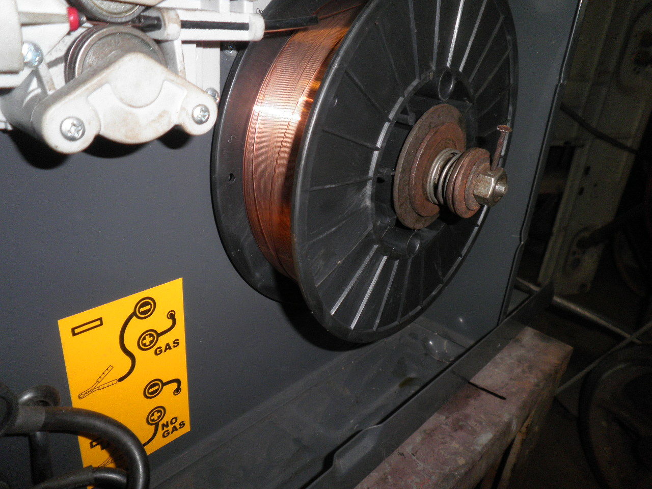

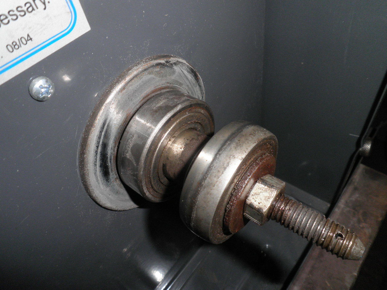

Got rid of the too expensive 2# spool of mig wire and put on my own adaptor for the 10 # spool of mig wire, just took the small bolt that the 2# spool was on and added a longer bolt for the 10 pound spool,the added the bearing too reduce resistance on the drive motor.and put nail in bolt too hold the tension in place.
I like it : ) Necessity is the Mother of invention.
