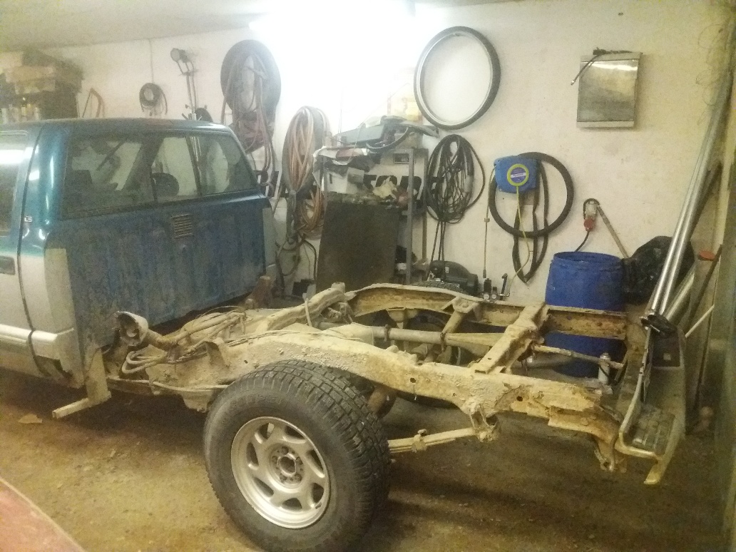

Thanks Bob, I would be happy if the car comes up to 75mph (120kmh), so fast I almost never go with any of the gasoline cars, will see if I can get place for 2.5 or 3" tube.

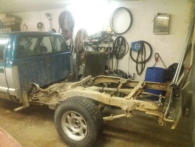

I inspected the car for the first time, got some things yo fixe, so I’m waiting for parts from the USA.

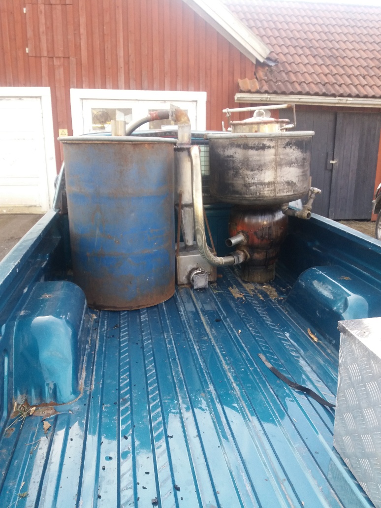

Looked at how to put things on the car, the aggregates then cyclone, and last filter of clay balls and steel net, then cooling.
What do you think about that set?
