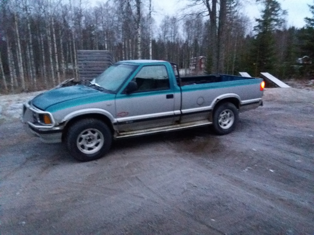

Oh what a lot of rust there is, wonder if I can make a car on this again.
Looks fine to me, better than a lot of trucks around here. As long as the frame is solid! Congrats! :grin:
Congratulations Jan! What year and engine is it?
Well, both front fenders both drawers(under door) both cab corners one rear fender one corner behind rust damaged.
The frame is very rusty but no holes what I have seen yet, but has not been under.
1995a, 4.3, L35 and CPI.
Hope I get it together.
