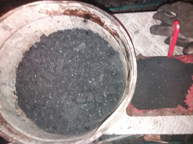

Looked at the fire pipe this morning, but sees nothing strange except the ash around the nozzles, should it be like this?
I know I would not touch things, but want to know what is wrong.
Hi Jan, it sounds like everything is running great at first, right? And then it starts to lose power? If what I see in the bucket is out of your fire tube? Where are the bigger pieces of charcoal that should be On top around the nozzles or tuyeres in the upper part of the gasifer. See a lot of smaller fines and black/grayish ash in the bucket. Looks like you are constipated or plugged up to me.
Next run use bigger pieces of wood mixed in with the same stuff you a using right now. If it improves add more bigger pieces to your normal mix on the next run ect.
When you get back home. Try to have the hopper almost empty. Shut it down making sure the intake air blocked off. The next morning look into the hopper and take a picture of it. Then probe into the hopper carefully and feel if it is lose or a tight in the charcoal bed. Poke down through the holes in the grate. If it is easy for the rod to poke down that is good.
I always poke 7 to 10 times through the grate in different holes checking my charcoal bed and checking my charcoal reserves out. Keep using larger pieces in with your mix. I use pieces the size of my fist and a little bigger. If you put larger pieces of wood in this will help free up a tight charcoal bed.
Hope this helps you out.
It is really hard to tell once the charcoal is all disturbed dumped into the bucket.
Screen all the fines out before you load the firetube back up again.
What is in the bucket is from the ash hatch, there were nice big pieces of charcoal above the nozzles.
I also think it seems tight, but can not find where it is, the carbon bed seems quite loose.
I thought it was tight on the grate, but see no faults there.
