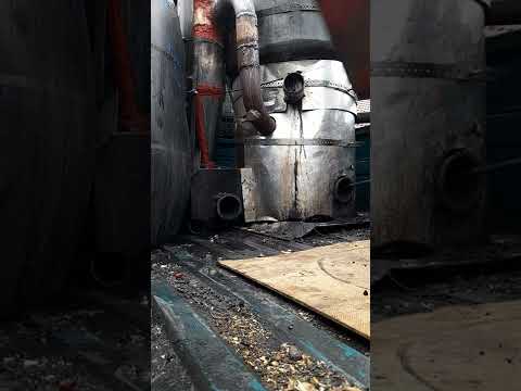

Looks like that cyclone does a great job at filtering out the small stuff!
I was in to Ludvika today, our nearest town, I saw no more gengas car in the parking lot.
As usual I was worried on the bigger road, so the rpm got a little too high for the filter.
Do you have stiffners in the barrel like Bob and Don have?
I have some rebar, but they want to fold, would have welded them together into a ladder, but am a little lazy.
As the famous saying goes: âBetter a flat barrel than a flat tireâ
Talking of tires - since you keep your spare tire in the filter barrel, maybe it could somehow be part of a barrel support
Wooden round pieces with holes in them is what I use. They came from cable spools. Bottom one seats off the bottom on top of a plastic bucket with holes in it. Then the hayfilter laundry bags. On top of that one more wooden spool end. My barrel is straight sided. I notice you had no hay in your filter barrel. I would build a frame spool and drop it in. I can see my barrel flexing on hard vaccum pulls but it does not collapse.
Here is a drawing of what I am talking about.
You could put more then 4 barrel wall supports in.
I think I saw your solution before, it seems to work well, I have tested with a few different filters, so it has not been possible to build in the barrel.
