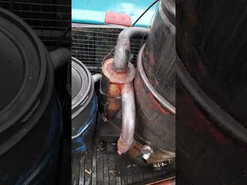

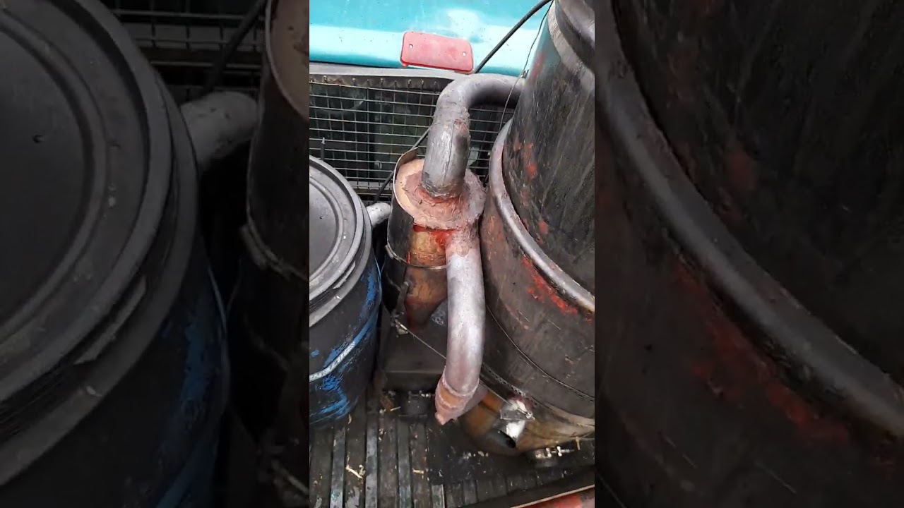

Thanks for the start up and ride video Jan. Did I understand that you switched off the petrol once you got on the main road? I have to keep my rpm’s higher at first to get the gasifier going better. It sounds like you were idling until the main road and had to use the starter a couple times.
Yes, I tested once before the main road, and then once on the main road, usually starts at 140f on outgoing gas from the unit, it is sensitive on the secondary air I have a pretty big throttle there.
I made the video this morning, 6.30am, but posted it when I got home at 11.00am
