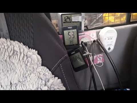

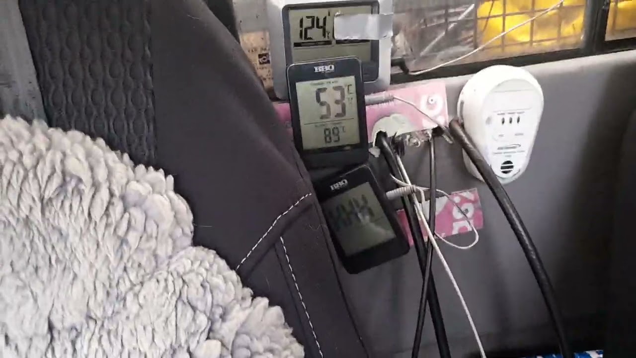

Top thermometer is temp out of filter, next is top of hopper, bottom is into filter over 300 degrees c.
Resistance across filter in mbar.
