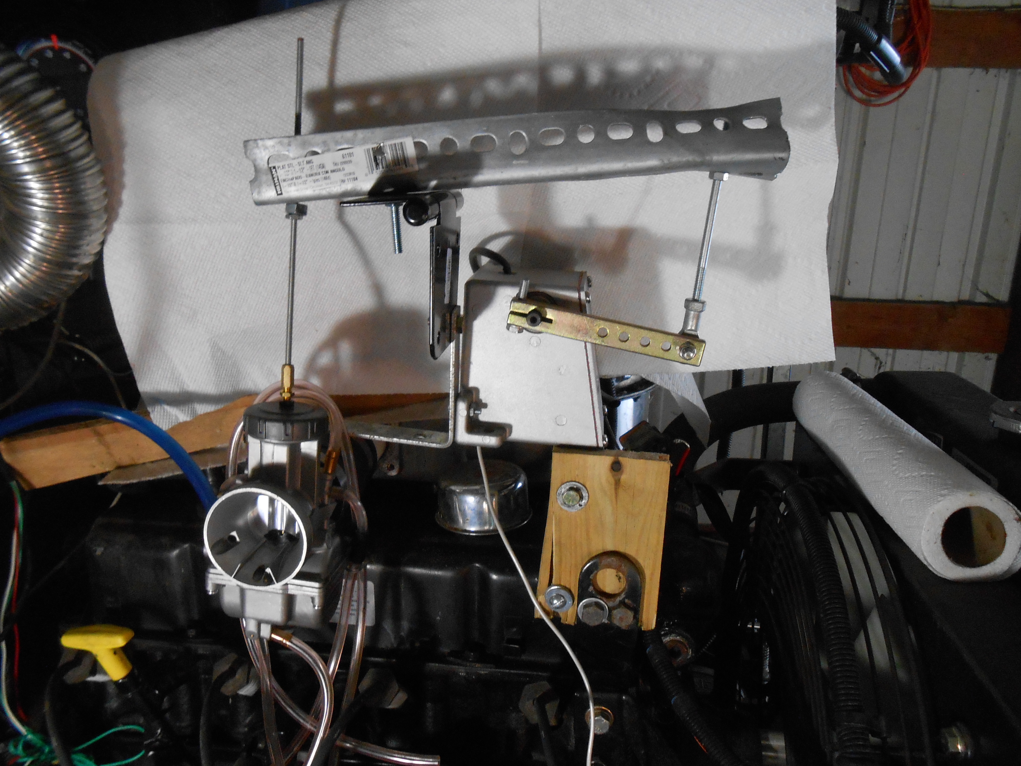

Roger Blomli said he wanted to use DSE8620 I have the DSE8610 and do not want it . can not use it . I thought I had to get rid of it but I do not have to . I replaced the governor I do not need dse8610

I have sticking valves . replaced governor . issues with generator .
I just want to be able to run motor without gasifier .

I had gasifier running generator feeding charger , battery , inverter to grid tie today . did not have lambda , there is one it is not working . just jammed stuff in pipe , air fuel adjustment .
air inlet for gasifier was clogged , cleared that some how . fuel switch was jammed then fuel auger jammed , governor was not maintaining speed . Held linkage to hold speed then it held speed on its own ⌠then it stopped . battery dead done .
normal operation 50 gallons of wood chips over hour run . Mowed lawn while generator running . Started gasifier extended light time . cranked engine , no power to ignition . Cut wire and connected to 12 volt . Engine starts but will not run . pulled second spark plug . Engine runs with second plug removed . Can not get engine to run stability at 1800 rpm . adjust voltage run at 1600 rpm . three phase 240 volt to 48 volt 130 amp charger . I never shut off inverter . I use disconnect from grid to control inverter . Generator rated at 20 Kw . I am trying to keep up with output from inverter to grid from battery of 7.6 Kw single phase . Shut down disconnect from grid , disconnect from charger . run engine for 10 minutes of gasoline , shut off gas .

purchased clcs600 came with control module and lambda (stepper motor )
had to add vacuum sensor , GM sensor rebuilt for 12 volt called MAP or TPS signal
bosh single wire oxygen sensor called lambda sensor
wire for engine control unit went to coil , tachometer
seems to try to work
The auger motor broke lose and knock off vacuum sensor that filled up with tar . I removed all electronic controls .
I have two, one inch gate valves . one for air (no pre heat ) to gasifier . one for mixing air with wood gas . throttle is loop of cord and clothes pin . Air mixing with wood gas seems to actually control engine speed⌠auger failed . chuck broke off drill .
Had to use 3/8 ratchet as auger drive . very tiring . found air leak . glowing red . when fixed should work better . Battery dropped to 17 % . Then with out touching battery or connecting anything it went back to 100% . had several hour run at 7.7 KW

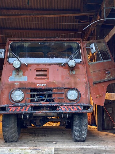

Hi guys,
Now my army days are over and i am in my new work in the poultry industry.
I have in this time gathered equipment that i like to use in my future projects.
Since i have so many Volvo engines and equipment, that would be my main focus.
My working turnus now let me have 1 week a month free to work on energy to my farm and houses, wood is free to me, i just need to get it, so now im in the thought process on what would be the best energy for the buck.
