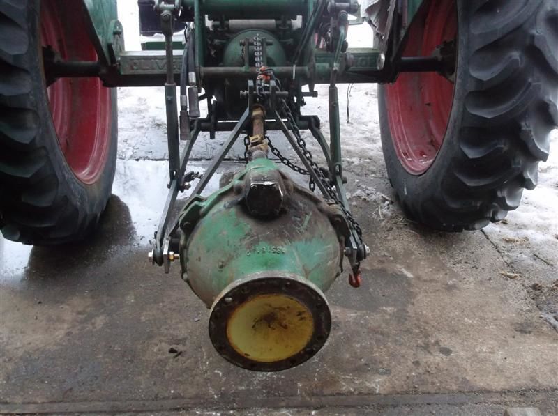

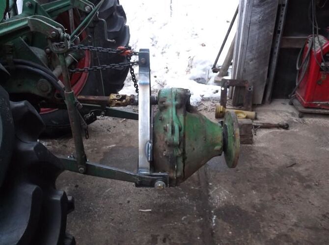

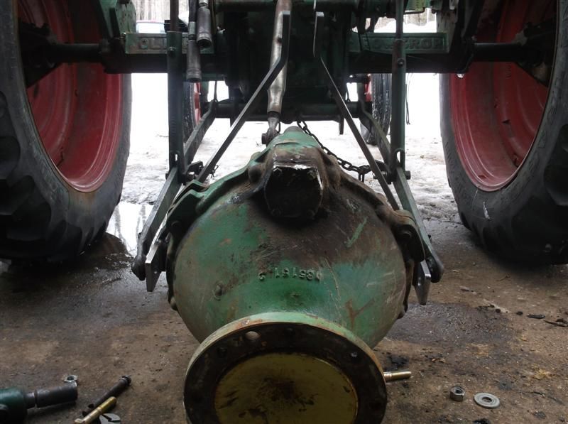

started the wood chunker project today
Hello Dan and welcome to the DOW.
Thanks for posting the pictures .
Looks like you will have plenty torque !!
Hello Mr Keith
I think you know whear it came from. i was hoping to have a little more done today but got called into work
Looks like a John Deere final reduction ?
winner! has 10 to 1 or better. 380 lbs of deer iron on my oilver 77 diesel. thinking about a 12-14" cutter and elavator going to the dump trailer.
I cut alot of wood every year and no sense leaving the sticks behind at least not any more!
Good looking gear box, green and yellow, yup, seen that before. About 10:1 ??
can’t rember the model #6200? any way you could get 3 or so ratios lowest around15 to 1 higest around 10 to 1 .depending on the tractor rpm it would be about 60 rpm give or take at the cutter
Wow, that will deliver plenty of torque.
Oliver green and Deere green, that works :slight_smile:

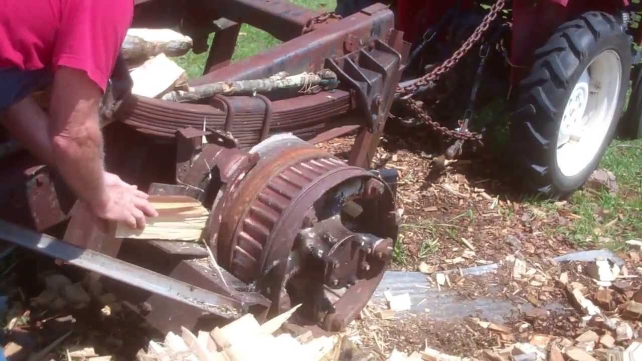

I had some cull logs I needed to get out of my way so I chunked some of them today . I cut them in fire wood lengths and split them enough that the wood chunker spliter will take them on down to chunking size .
I like to use sawmill edgings and small slabs because they need no prep but some time I run out of sawmill waste .
After I get the logs busted into smaller pieces the below video shows the chunker splitting and chunking .
Also a couple of pictures from this afternoon .

thanks for the new viedo i will be changing the the size and shape of the feed hole. is the cut “vee” shape at the top shaped like that to keep the wood from twisting when cutting at that near rip cut angle? we had 6" of snow yesterday,march in like a lion out like a lion or something like that.

I added the little v shape to the chunker after I realized some of the bigger slabs wouldn’t fit in. Some time I will have a very thin slab but it may be 8-10 inches wide.
. If you feed the slab in to the chunker with the flat side to the cutter it will fracture and cut also , making 2-4 chunks per cut .
