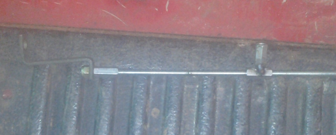

This one I had made for my torch but with a hose clamp the plasma cutter works pretty good with it. Just some 1/4" all thread rod, lock nuts on the ends and some coupler nuts welded into a “T”.
I’m just drilling a 1/4" hole for the center now. Need to find a magnet from a speaker or something in case I don’t want to drill a center hole.

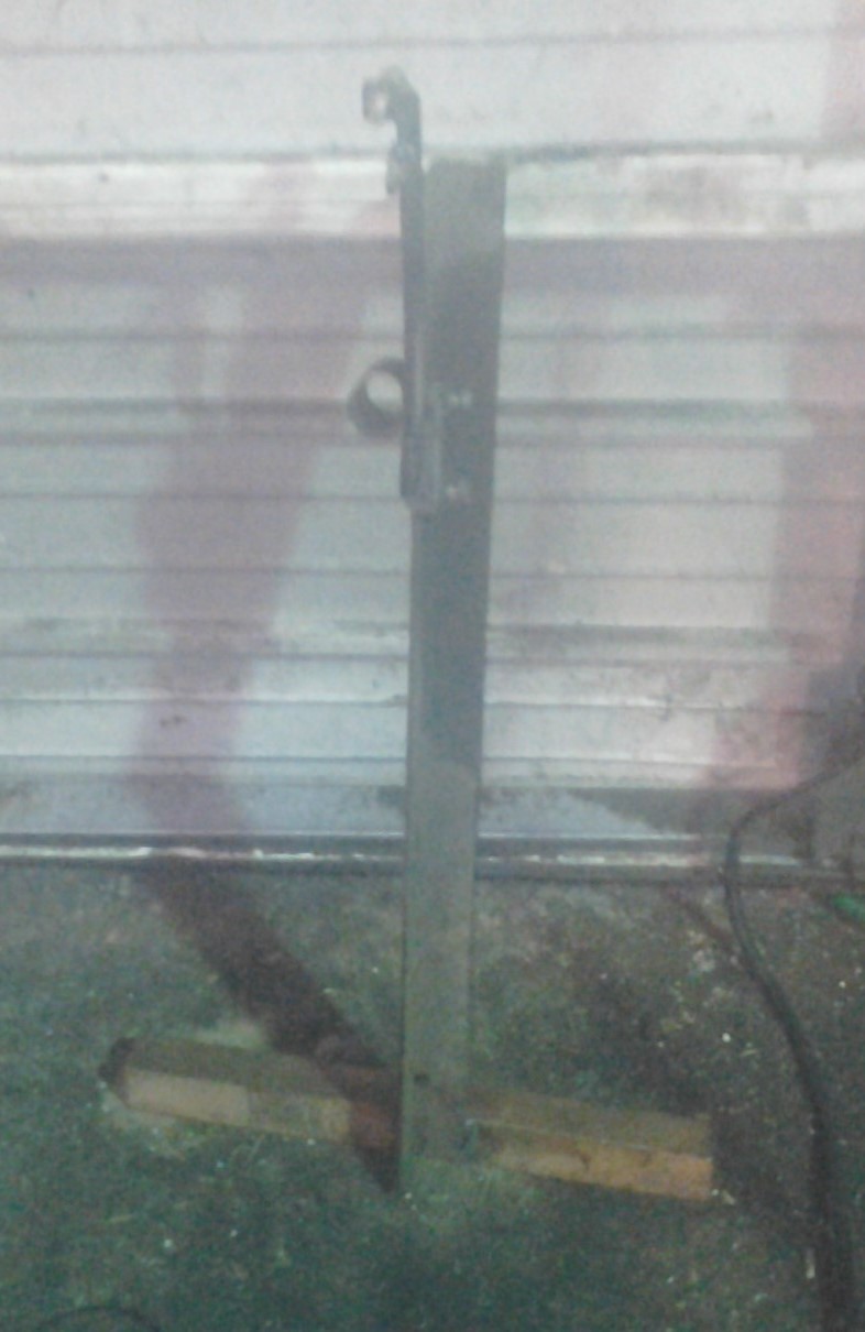

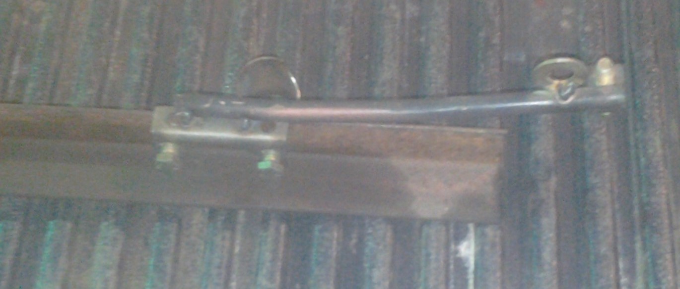

This was built to cut a straight line from the edge of a panel like a t square. Found out this last weekend it works great for cutting tanks or barrels even. Just put it up like the second picture and slide it around the tank.
The piece that clamps to the angle iron was part of a muffler clamp with two nuts welded on. The head of the torch sets in a piece of pipe and the handle rest against the washer and a bolt.
