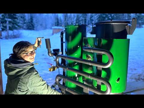

Do you think its possible to add a condenser to remove water vapor from wet wood?
I stumbled upon this video where they had problems when using wet wood and could not ignite the syngas.
Hello Veljko,
Most raw wood gasifier designs since the late mid-1940’s do have upper wood fuel moisture condensing hoppers. These were named from then Monerators. Specific informations on the origins of this are in the DOW Library section.
On this video shown system you can see internal detailing of this in Ben Peterson’s design books, “Woodgasifers Builders Bible” in three versions, 2012-to present. This particular build up is an unauthorized illegal sold kit-copy from that book. These folks buying and assembling this do not realize they have stumbled in to a legal action lawsuit.
You can also see moisture reducing monorating hoppers in Vesa Mikkonen’s system design book, “Wood Gas For Mobile Applications” published out from the early 2000’s to present. Mine is a 2010 copy.
And these feature can also been seen in Wayne Keith’s and Chris Saenz’s book published in 2013, available here on the DOW.
In all of these it becomes very apparent that size does indeed matter a lot.
The bigger the system then the more available internal heat and space capability for wet wood heating steaming out; and then cooling condensing out and externally removing that woods excessive moisture.
View through pictures of the W.K. systems that have been built shown here on the DOW site and all done properly by the WK books recommend design have large external visible additional around the fuel bin hopper condenser cooling tubes. And those systems having TWO (an upper and lower) condensate collecting trough-gutters.
Back to the Canadian folks in this video. The wetness of the wood they were using exceeded the capability of this systems monorating system. At some point they will have to realize that heat is being shed off of their single pass cooling tubes. Once they go forward with IC engine woodgas fueled running then that engine will have available heats from the engines cylinder, cylinder head, engine oil, and engine exhaust. ALL of these can be used to just-in-time heat and circulations removed wet woods moistures BEFORE putting that wood into the gasifiers hopper. Going on to electrical generating the electrical generator assembly will have shed off blowing heat that can be used too.
Few have ever pursued using these made, need to blow away heats for wood fuel improving benefits.
Dry and warm the wood before putting into the gasifier and then the gasifier itself can be simpler and have much better performances. Connecticut man D. Nichols; New Zealand man Doug Williams; and USA Ben Peterson all have show using, various use of systems heats to before the gasifier pre-condition fuel woods in the past 20 years.
In ALL system for from a cold starting up it is best to get it all up to good working temperature to use very dry pre-charcoal loading. Then initially adding only very dry wood.
Later once all is up to good stable working temperatures; then can be transitioned over to wetter woods.

So you basically say, forget the condenser dry the wood beforehand.
Perhaps I can just put them in the oven of the wood stove while cooking
I dont want to interup your chat with steve- but the cooling tubes on the hopper and the bed of the truck cooling rack is the condencer- i just HAS to be able to be cleaned. any more cooling tubes or condencing tubes,are too much extra weight for mobel driving. The wood need be around i think 25% max moisture. with a wood moisture meter. But if you chunk a big pile of wood up ahead of time, chunked wood dried in about a few weeks from what they say here on DOW.THE small chunks dry real fast compared to big slabs of fire wood.
What they are currently talking about with barrels and an old oil tank Veljko would be condenser drying the wood before hand. They propose using sun solar to heat.
