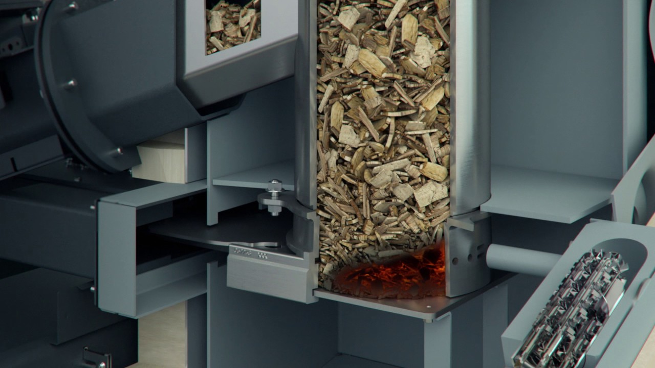

Just found this continuous feeding updraft gasifier design on youtube from an Austrian company.
It is part of a boiler, but with secondary air off, it is an updraft gasifier.
The interesting part of this boiler is multiple design elements that allows continuous operation – including the online ash removal and anti-jam auger.
They claim this boiler can output 400kw of heat with 1.36 cubic meter dimension, translating to 100kw (134hp) of engine power for a 25% efficiency Otto engine, which is enough for a commercial freight truck.
https://www.windhager.com/int_en/products/wood-chip/purowin/
Hi Cow Dog,
There are many things what this can be called / used for, but i doubt the useability for IC engine purpose…
From my perspective: any company that try’s to sell such a product with the claim “zero-emission” ends up with my thumb down…
Its a smoke maker, period…
I can guess it means low emission when running in ideal conditions, and a lot of smoke starting, stopping and when the chip bridge falls.
CO2 emission rings a bell ?
PM 2.5 ?
