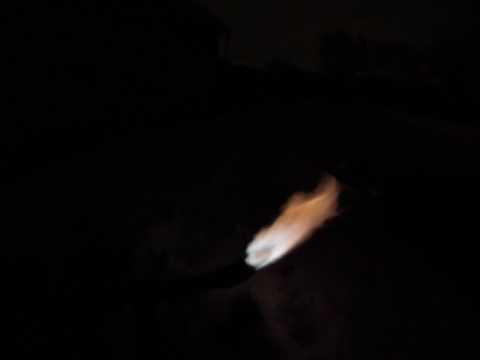

Craig; Nice looking flare.TomC

Your flame colors look really good. If you go to the Small engine category and scroll down to âMy first small engine runâ comment 59, at 1m53s at the end of that clip I demonstrate exactly what Dave proposes. It works great.
