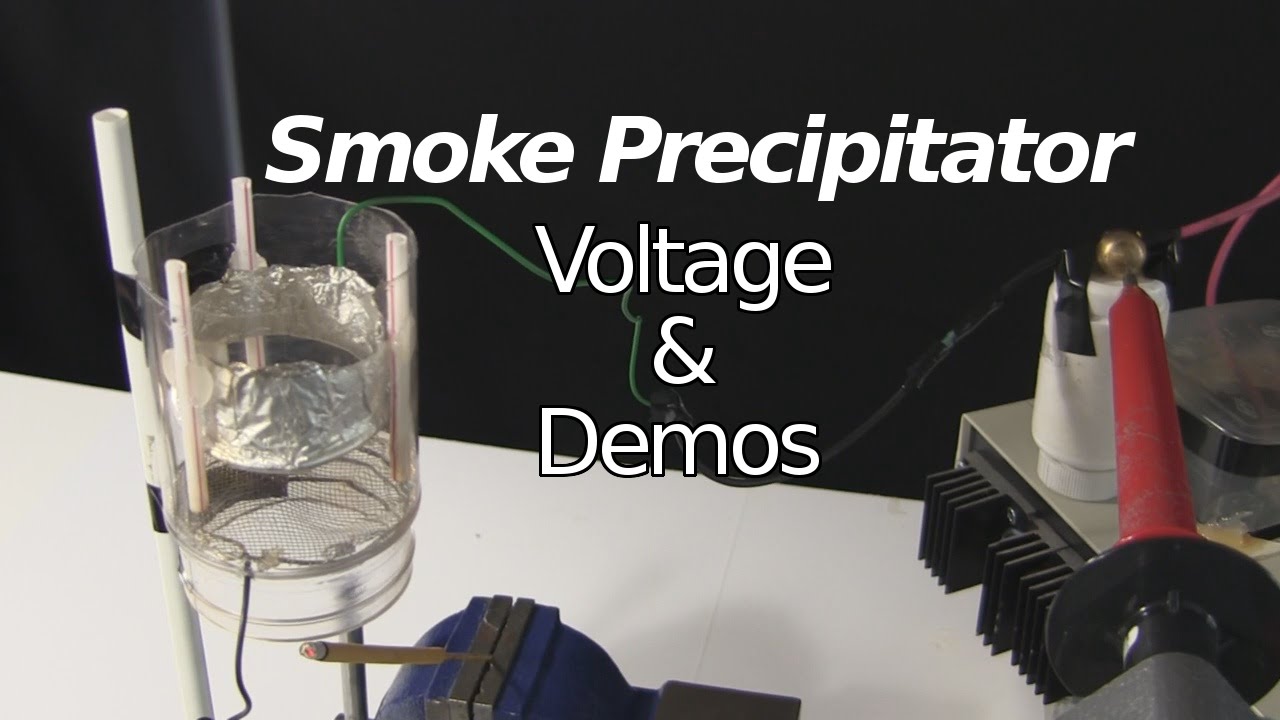

Also, curious if anyone has ever looked into electrostatic precipitators for filtering air. They certainly don’t seem friendly with their crazy high voltage and guarantee of occasional sparks, but I wonder if it can be done safely using some flashback arrestors and oxygen sensors to assure no oxygen is present in the line. Would be nice to just whisk any tar and particulates out of the gas…
(at the least, an electrostatic precipitator could probbaly lower the tailpipe emissions pretty well)
Yes. Electrostatic filtering has been tried.
First the wattage requirements. You must pre-store it. or live generate it.
Worse, all system regardless of the “No Tars” claims will make a lot of wet sticky tars when warming up to hearth to internal stability.
One Operator too early flowing through the ESP will goo clog it up big time. Quite the mess to cleaning up then, NOT damaging the unit. (Hot steam)
Billy think of restaurant cooking hoods. You must capture that level of goo’s with early gas. With system ran down eating up it’s char bed then hot wood refueling now dirty gas.
