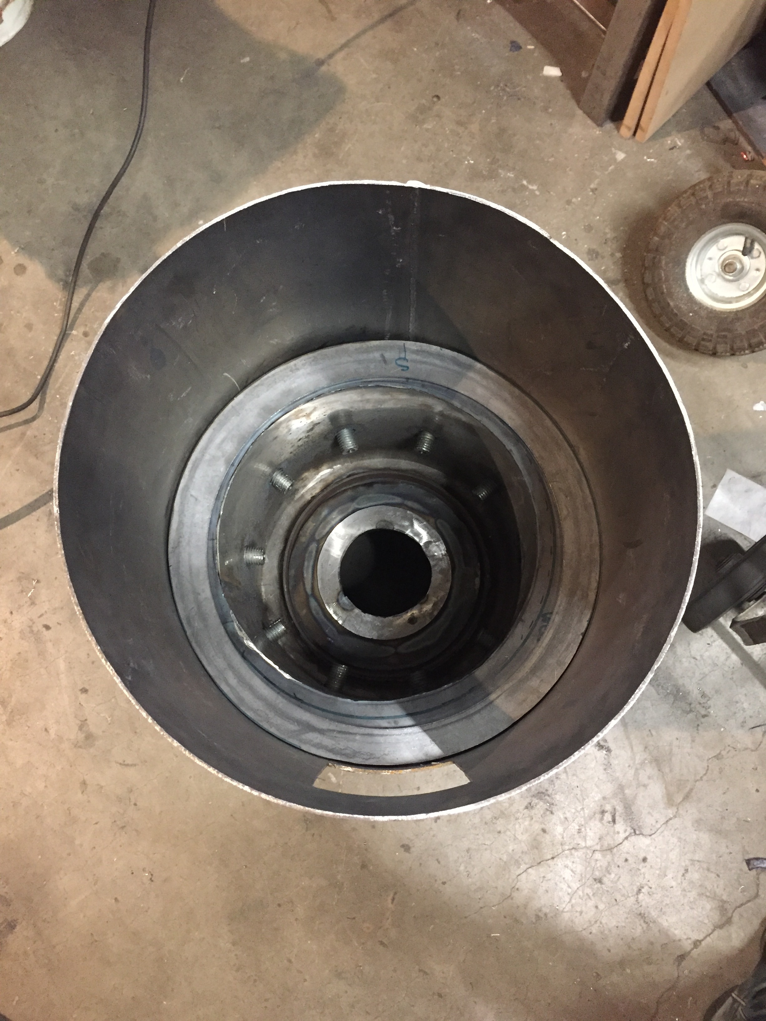

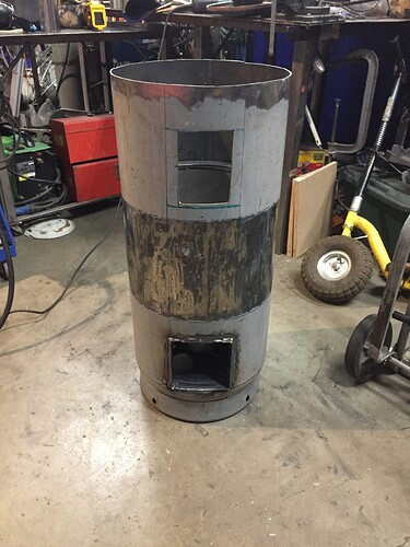

A bit about the bus. It’s a 30-foot, 1999 Chevy Bluebird/B7 with a 454 gasoline engine. It was converted by the school system in Texas to run propane. Over the past several weeks, I’ve been fabricating a wood gasification system to be mounted on the rear. I’ve settled on a downdraft reactor based on the one in the Wood Gasifier Builder’s Bible, which seems to be a popular build. I’ll be mounting a light-weight stainless steel drum on top as a hopper for additional fuel capacity. Some other interventions are likely in order, and I have a great deal of flexibility with size and weight. I’ll be mounting everything to a very heavy-duty 32" deck on the back, which will be connected directly to the bus chassis. Radiator, condenser, and filter still to come!

Hi Billy, welcome to DOW. A 454 cubic in. engine will require a larger restiction or choke plate than 4". The WK Gasifiers are running 7" to 8" restriction openings my gasifer is running at a 7 1/4" opening with a 318 cubic in. engine. Not sure how large your gasifer can run with out making tar. Read the specific on your gasifer build to find out. I burn a pound of wood per mile of travel at high speeds, less at 40 mph and lower speeds. There are lots of free pallets to be found. A very good wood source. It seems every town has them for free to take away. I would figure a heavy school bus with a big engine will burn more wood per mile may be 2 lbs. per mile.

I am only going to address your use of Ben Petersons Book and Book-system as the basis for you attempt.
I am very, very hands on familiar with most all of his stainless steel systems.
I never had an interest to operate any of his earlier 5-7 carbon steel systems.
And I’ve yet to hands on operate one of his made-by-plans Book systems. Fellows actually electrical generator running says works fine for them.
His Book system will be too small for your proposed usage.
And what is this talk about '“lower moisture” collection??
Not in the book. Never been in any of his hearthing systems. And only a few (NOT the Book system) had hopper condensation features. Down stream separations, cooling and filtering; sure moisture collecting at these points; sure all systems.
Page 29 of his 2020 Mastery Edition says system dimensions maximum for a 5.0L (302CID) engine.
You want to fuel a very heavily loaded down 454CID engine.
1/2 again times bigger engine; and with the greater system demand loading, than a 302CID would ever have, you will need to greatly increase the gasifier dimensions.
Greater gas production demands will mean greater thermal heating the metals have to resist and dissipate.
He uses thicker metals propane tanks, with smaller engines and lower gas loading demands.

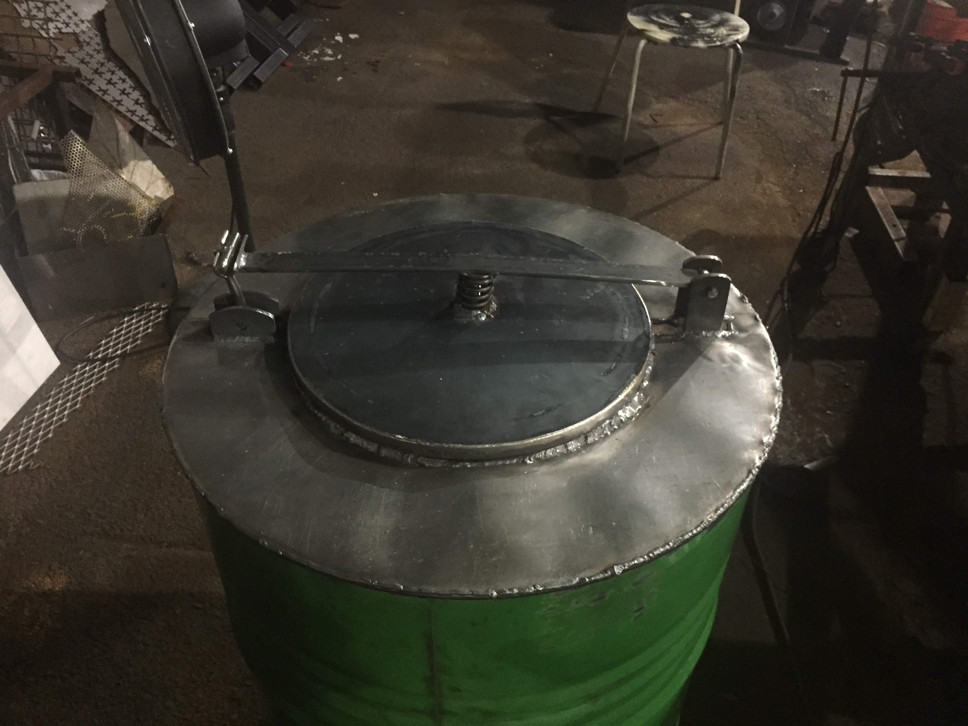

You are trying to use thin 55 gallon barrels.
So please do not call your not-proven, DIY make-up, a Ben Peterson. You are far off his published proven pathways.
With your engine size and loading use you would be much better off, DOW Premium Member signing up, and supported building up a WK system.

Thanks for your good points about the reactor size, Steve. I agree it seems I will likely have to change elements of the reactor or run it as a hybrid with the current propane system. I certainly do not want to push it into tar-production territory.
As for the design, the reactor is, as you say of the Peterson reactor design, fabricated from various propane tanks. The walls are thick, and the combustion zone uses an even heavier gauge for the inner, rolled stainless cylinder.
Distinct from the reactor, the thinner steel drum you mentioned is for the hopper, which must be wider than the reactor and will condense moisture around its cooler surfaces. I don’t intend to expose it to substantial heat, but the idea is that it will receive radiant heat from the reactor and force moisture from the fuel to the outside of the container where it may then condense. The hopper will have its own drain. That’s all I meant by moisture collection.
No intention here to offend your reverence for the Peterson builds. I simply followed plans for the reactor quite faithfully because they were freely available online. (see schematics offered for free from proceeds of his publications, as well as many YouTube instructional videos. I think page 9 of the pdf mentions a “condensate collector” that I riffed on) The few other design adjustment I made were to introduce more air jets, a wider air intake, increase the height of the jets above the choke, and perhaps now a widened choke mouth as well.
Hindsight is 20/20, and perhaps I would have done better to riff off of the WK instead. As things stand now though, I have an excellent, perhaps under-powered reactor which can also be used to power a generator and auxiliary heating systems. It may need to be run as a propane hybrid, or perhaps just at reduced power. We’ll see!
