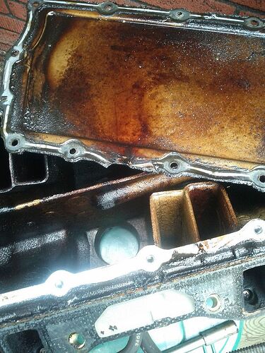

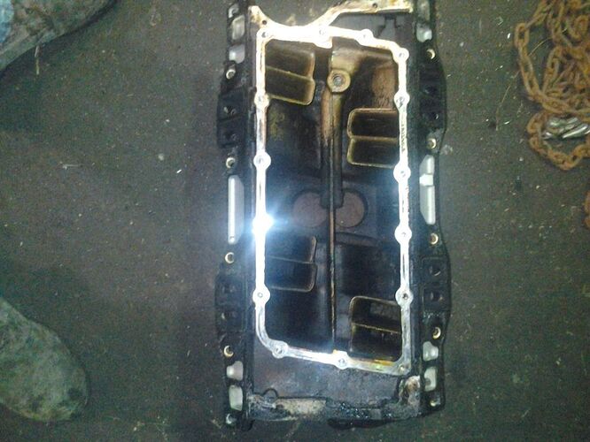

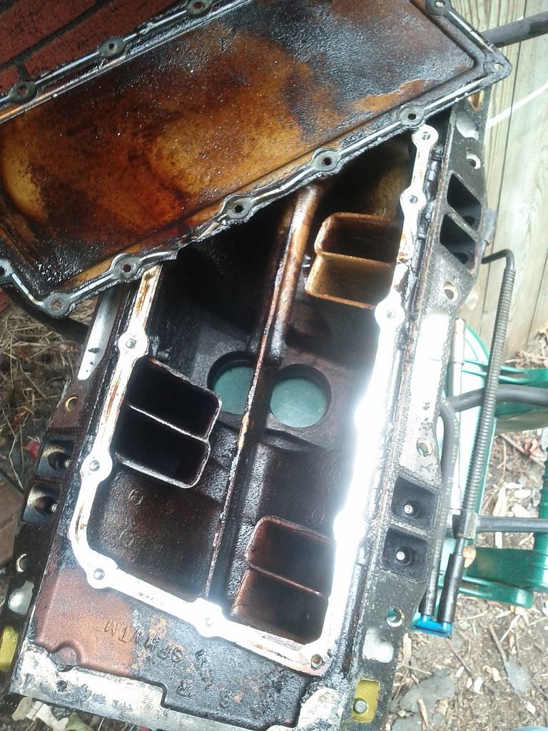

apparently it is very common for the gasket on the underside of the intake manifold (plenum pan gasket) to let go and allow crankcase oil into the intake manifold which then coats the inner portion of the intake manifold and creates deposits in your cylinders which can cause pinging upon acceleration/heavy load (on gasoline) poor idle, loss of oil etc.
Do to pinging under heavy load I suspected mine was gone and sure enough it was. I replaced the gasket, new spark plugs, and ran some sea-foam through the brake booster line and added to the fuel tank. Ran it for a little bit today and has made a notable difference.

If yours has the divider seafoam may not reach but one side very well.

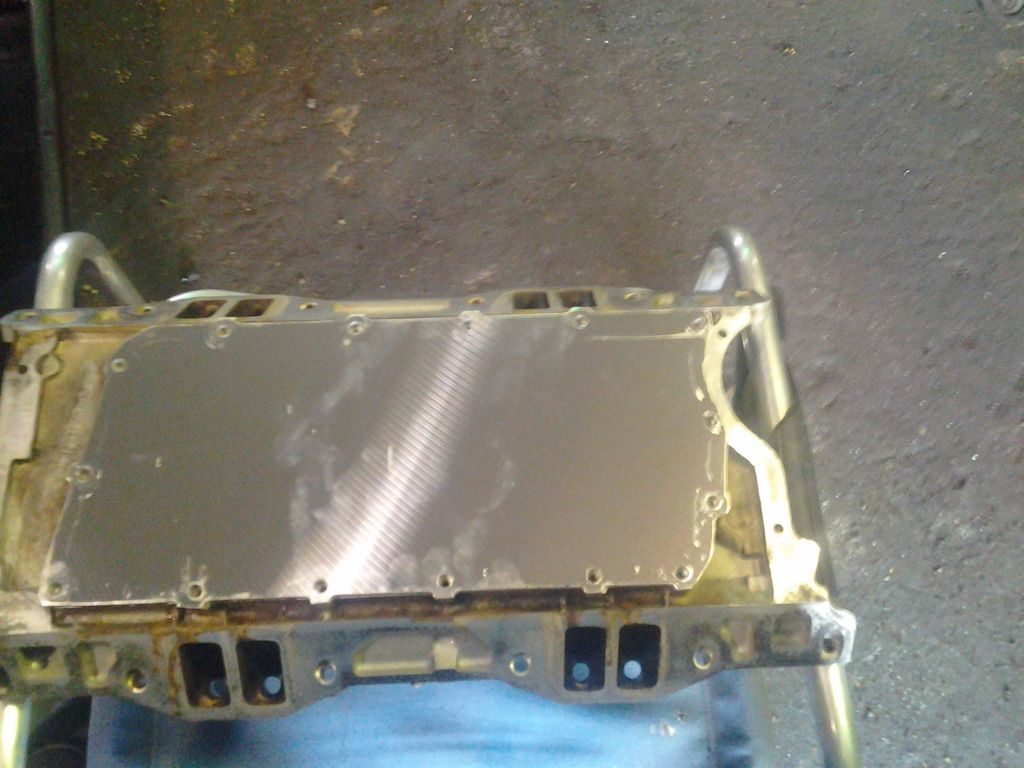

I made a plate like Mr Hightowers out of 1/4" aluminum. Took the time to do a little porting to open things up while I was there.
Marvin

Never thought about the divider, may have to pour some through a vacuum line on the other side, thanks for the heads up.

I didn’t go all out. Just raised the bottom of the runners about 3/8" and blended them back in. Raised the divider about a 1/2". I was worried about pushrod clearance with the thicker plate. Checked without the gaskets and it was close but OK. Just something to check if your making your own plate.
The ports did seem small and long like the old tuned port Chevys.
