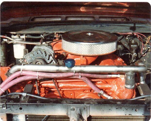

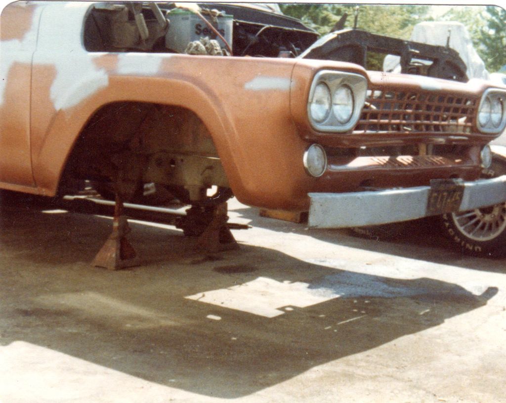

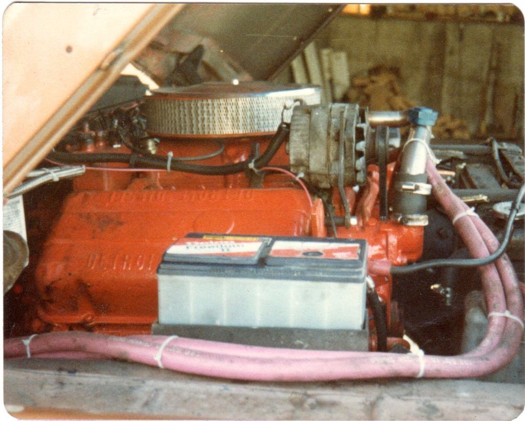

One of my 1970s projects. 1958 Ford Panel Delivery with a 6v 53 Detroit, 285 Clarke 5 spd, divorced dana transfer case, Dana 60 front & rear end.
A bread truck! Fantastic! I guess the bottom line is: Anything will fit in anything, if you know how.
Awesome !!!
love the rectangular head lights
