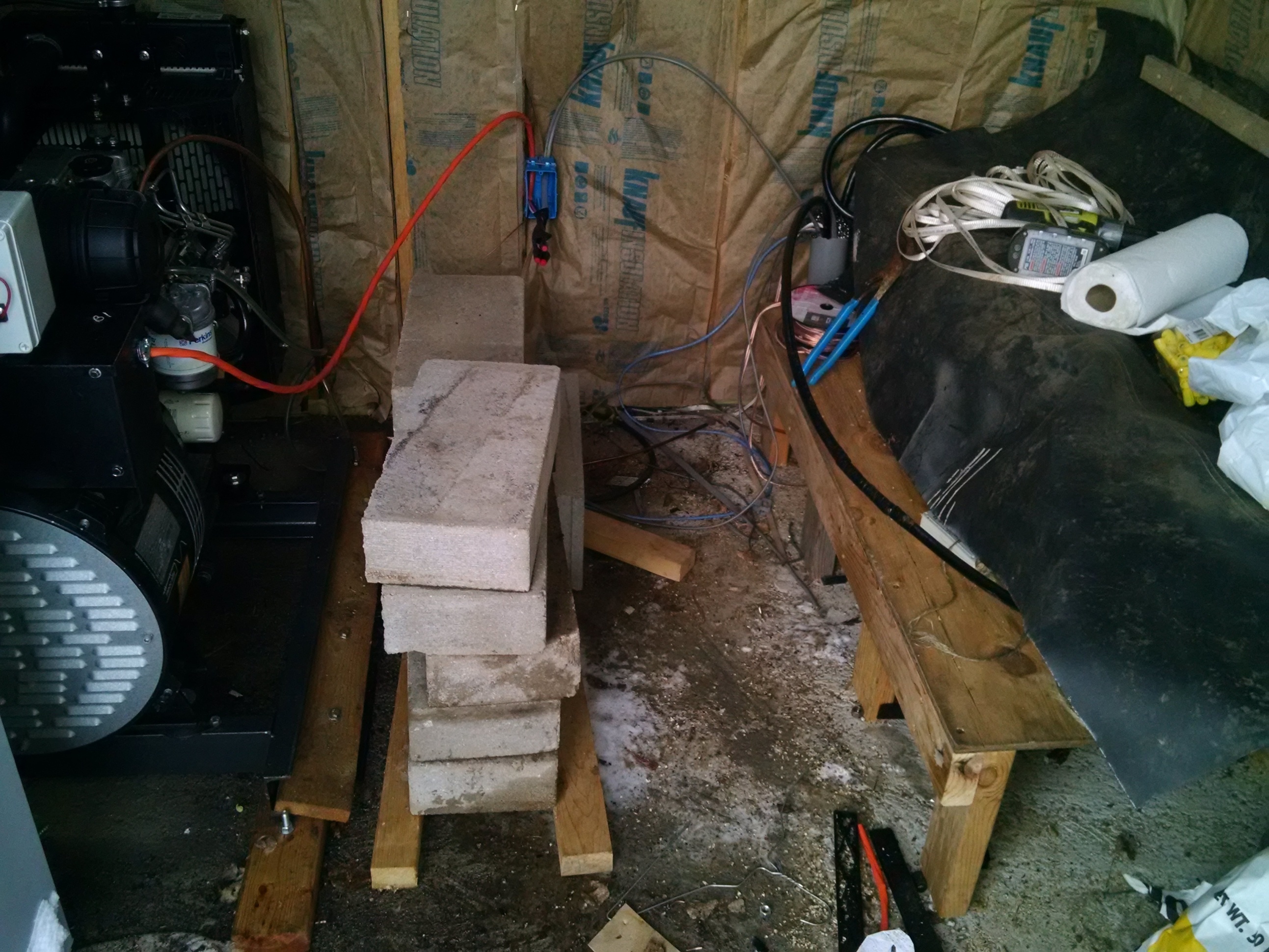

I finished insulating yesterday, didn’t have time to poly it because we ran out of daylight at 4:30PM. I gathered up cinder blocks and stacked 2 rows, 2’ high. I need to look around for more block. I placed the blocks between the generator and the batteries. At 5PM I started the generator and ran it until 7PM. At 10PM I ran the generator again for another 2 hours. I notice a considerable amount of charging capacity. I woke up this morning and it was -6F and the generator shed temp was at 27F after 7 hours. That’s a huge difference from yesterday morning where there was only a 5 degree difference with the outdoor temp.
Now if I can heat up the concrete floor with the cooling system of the generator. I’m just not sure if a 2 hour run will be long enough to make a difference.
Could you run your coolant into an insulated drum to store more of that waste heat? I know my boiler(200 gal) at 190 degrees will heat the home for a few hours after the fire is out. You have colder temps, but a smaller area to heat.
I ran 80’ of PEX under the 5 1/2" of concrete floor. My goal is to circulate the coolant through the floor and use the floor as a heatsink.

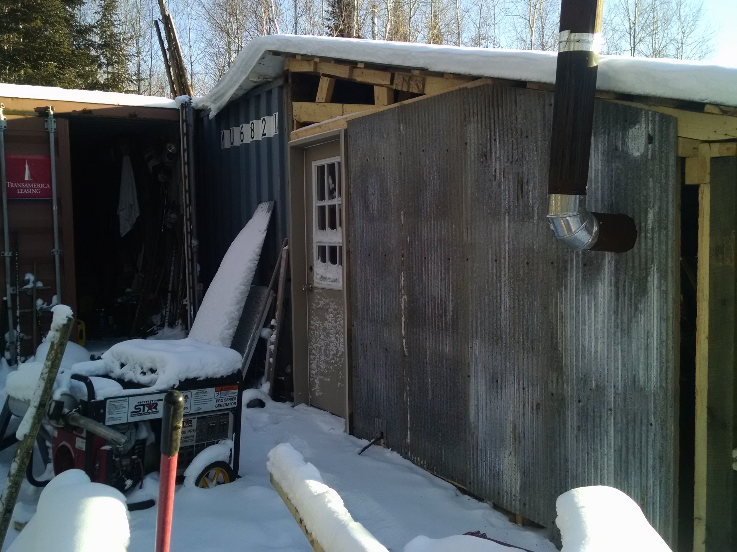

The last wall is almost done. Here is the door that swings in. This door gives me direct access to my back shipping container.
I see you have your single thickness stove pipe chimney in place. I bet you are going to have to waste a little heat up the chimney in order to maintain a draft when it is really cold. What kind of wood stove will it hook up to? Do you plan to heat it just to take the edge off the cold or enough to take your coat off? Lookin good!
Yes Don it is a single walled stove pipe I had laying around. I have a top for it somewhere under the snow. I just need to dig for it. I also have a free wood stove I believe from the 70’s. There isn’t anything efficient about it. Just having the walls and roof up without wind makes it a lot easier to work outside. I have a rebate check from Menard’s I’m going to use to get some insulation. I should have enough for the ceiling and hopefully for the walls too. I’m in a way better situation than last year this time.
Once lived in northern Wis. Had about the same stove pipe setup. Any creasote would condense inside the single wall out in cold. Not a big deal but had to clean the pipes several times every winter. Am in southern Co. now and its 54* at 9:00 PM but will have a high of 20* Sat. Gess why I’m not in Wisconsin.
I have a similar setup on my cabin, the single wall pipe condenses all the tar and moisture, which just drips out the clean out tee, no dangerous accumulations yet. I’ve been burning dry birch and poplar, probably best if a vigorous fire is maintained, and inspect the chimney now and then. People have gotten away with worse in the past over lifetimes, including single wall pipe through canvas tents, so what I am saying is that the human element is essential. You are definitely living the dream, rather than begging technicians to provide you with everything.
Regards,
Thanks guys, that makes sense. I will be sure and keep an eye on it.
I did make sure it exited the wall away from the studs. I have plenty of Rock Wool to insulate between the inner and outer wall around the stove pipe.
