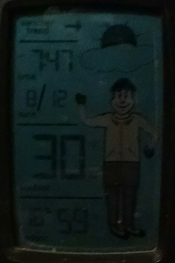

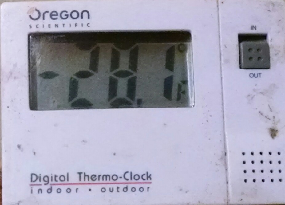

Our temperature at 7:30AM
The above temp is the temp at battery level after 8 hours of the generator running. Very happy about this. The bottom temp is in the house just after an hour of getting the wood stove going this morning.
