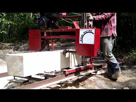

Aspen is one of my favorites. But it doesn’t hold nails well. When it dries you can pull them out with your fingers so makes good sheeting boards if nailed into something like hemlock. The saw dust likes to puff up when sawed and that can push your saw blade. Sometimes a wider set helps. Feel the dust under the board that is on top the cant. Nice if feels coolish and not warmish.
I can make a cant. It’s not pretty but it works.

Looking good Bill
