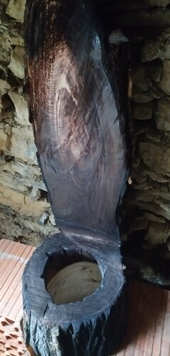

I am prepareing a detailed report for you guys soon, but for now, what do you think about my new temporairy toilet?
It was a coincidence the parasitic vine grew on the willow log at that exact spot but l decided l will leave it be ![]()

Thatās a beautiful piece of furniture. It would be my no1 choice for no2
Would not hurt to add some charcoal to the mix. ![]()
Welcome to the exciting world of human waste in plastic buckets! My toilet system uses 55 gallon drums, and after 2 years I am finally starting to feel like I am getting it figured out. What are you planning on doing when the bucket is full? (it will take less time than you think).

About as simple and as good as a toilet system could ever be.
Well she is not in the midle of the ābuisnessā here just to be clear
Yes this is a temporairy āsawdustā toilet however since l dont have any sawdust l use lime of now.
Thats great to know you guys have experiances with the stuff! I will most likely build a composting toilet in the house later on. But l am thinking to digg a shaft and a room under the wall of the house and have the composting action there, with acess to the pit from the outside. Shuld hold a conciderable amount of composting material, maybee only requireing emptying every second year or so.

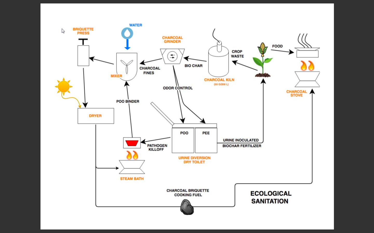

We have developed an effective Urine Diversion Dry Toilet (UDDT) for our friends in a remote farm village in Rwanda.
Since our waste streams come out separately, here are some reasons for keeping them separated AND for adding charcoal to each:
we excrete 10 times more pee than poo
Pathogens live in poo not in pee
combining pee and poo creates a cess pool
Almost all of the soil nutrients (especially nitrogen) are in the pee
charcoal is a good soil ammendment IF it is first inoculated with a good nutrient source like urine
charcoal aDsorbs instead of aBsorbs so it does not expand like sawdust
pee saturated charcoal does not slosh and spill like a bucket of liquid pee
The front pee bucket (full of inoculated biochar) can be conveniently emptied and added directly to the garden. The poo bucket remains in place and is emptied at a much longer interval
charcoal controls odor in both the pee pot and the poo pot.
poo is an excellent and energy dense binder for charcoal briquettes (heat poo to 165* F to kill pathogen nasties) Alternately, heat treated or composted poo can be used as fertilizer.

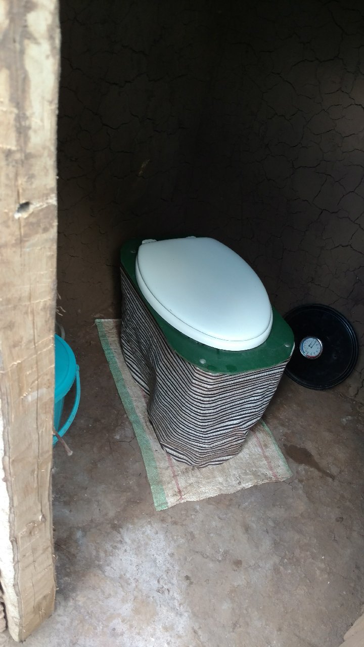

The UDDT trick is to form a flap to go over the gap where the pee pot and poo pot join. This holds pots together and keeps waste from falling between pots. Our friends in Rwanda use a 20 liter plastic water can sideways in front of a 20 liter round bucket. With the handle section of the plastic can carefully removed, the front side becomes a pee shield for boys and the back side is heated and bent over to form the afore mentioned āflap.ā An elongated toilet seat allows convenient aiming for men and women. The seat rests on a wood frame a few inches above the pots. This extra space keeps scrotums from touching the connecting flap.

With all respect for the efforts described, the āhumanureā system developed by Jenkins is superior, charcoal could be used as part of the biofilter cover material, given the absorbent cover material there is zero possible sloshing, the composting process addresses all pathogen issues, and could doubtless be abbreviated in the tropics, plus itās as dead simple as imaginable, one bucket, regular cleaning and change out.
Plus, I can speak from personal experience, there is no offensive odour issue even if left for months, composting gets underway right in the bucket, (a bucket of pee in the tropics or anywhere will develop a ādistinctive aromaā in no time flat), and there you have 100% nutrient recovery and pathogen chain break. I canāt speak highly enough about the system, it should be used everywhere, poor countries and rich. This completely eliminates the possibility of water laden sewage backing up in a basement, never a happy day, or contaminating well water or surface water.
Garry, Iām a long-time fan of the humanure system. As a fellow container based system (CBS) advocate, I agree that humanure is the best/simplest approach for breaking the pathogen chain in most contexts. Bacterial and fungal composts are wonderful.
Since our UDDTs use charcoal, they also have āno offensive odorā (years of personal experience). They are appropriate where compost-resistant crop-āwasteā is abundant and ends up as smoke. This alternative CBS helps supply poor families with cleaner and cheaper fuel, plus biochar. It thereby slows deforestation, sequesters carbon, and abates household respiratory disease.
