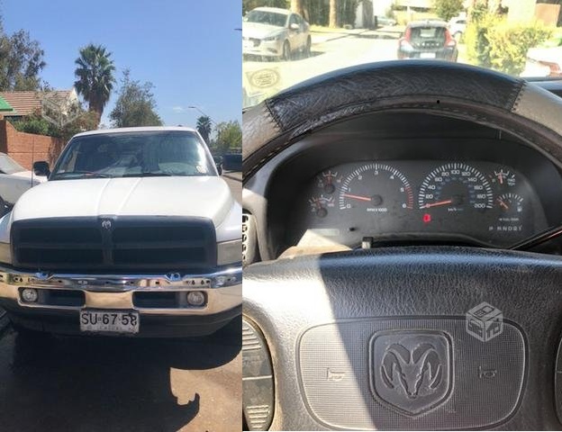

i found a DODGE RAM 1500 V8 5.2 LITER year 1999 for sale. it’s that the same engine dakotas have?
Hello Seti .
I believe the truck and motor combination should do well
for work and travel . It will be about 10 mph slower out on the road compared to a dakota. The dakota is not much for work vehicle but good on the road.
I believe the truck you mention above will be the same as this 94 Ram 318
ram1 this is the truck i mentioned
