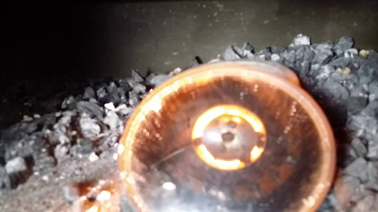

I opened up my ash collector ammo box and put a small convex mirror in there looking up at the nozzle from below just to see and hear how it burns. Here is a short video of it running that way.
don I like the view it shows how hot that is really getting I wish I could stick a camera in mine . and donât worry I wont say anything about burning down anything been there done that
exactly as you say Don; Thatâs how its doneâŚ
Amazingly charcoalâŚ
Talk about looking into the belly of the beast. How often do you have to turn your nozzle?TomC

When you cleaned out the top could you see any stratified layers like in a wood gasifier? From this picture it looks like the âfire ballâ is maybe 10-12" in dia, and I wonder how tall?
When I poker down with the rod I can feel the slag around the nozzle area but only about a couple inches high.
Don, does the slag stick to the metal, either on the nozzle or around the cooler metal to the outside? Iâm just curious if it just lays on the bottom and can be vacuumed out, maybe a sloped bottom, so it can roll to one side?
Bill that stuff just sort of hangs together in clumps that can be pinched into granules and then vacuumed out or settle out to the bottom. If I had a port that I could open there I could grab a clump at a time and just remove it. I saved some in a plastic bag and I will try to make a video of it being crushed in m y hand.
Yes, i believe I seen the stuff you gathered. I just wasnât sure if it adhered to the metal near or around the nozzle.
No it doesnât seem to stick to anything but itself.
