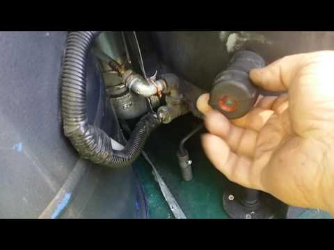

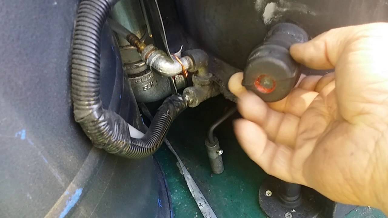

What is the black hose for that is coming out of the side and going into the water drip.
Hi Jim,
That is a wire protector that covers a thermocouple cable for my steam temperature reading.
Thanks Don
I knew that there was a good reason,----just looked out of place for a gas or air hose.

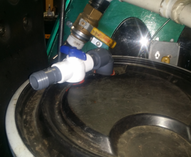

Latest addition to the Tracker is a wood gas connection and valve at the top of the filter barrel so I can run my 4500 watt generator on wood gas.
I can purge the air out of the sump hose by running the pusher blower and maybe even a modified burner for a grill. No end of stuff we can do with wood gas.
