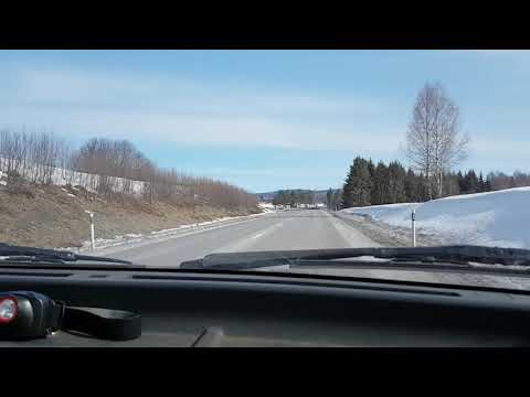

In the pic it shows  25c, ambient. This is after about 50km of drive, and temps will soon start riseing, and me looking for a filling spot.
This guage requires some skill to master. The thing is l have a insulated hopper that acts a whole lot different thain most others. Mainly, once its hot and neads a refill, it will not cool eaven when refilled. So, l first reaload when temps rise from 20-60c. Second, l reload when temps rise 60-80c. Third 80-100c, 4th 100-120c and then l run out of scale.
Plans are to fix this, add a nother lair of sheet steel on the existing hopper wall, between the wall and insulation. Intake air will be drawn trugh.
I think l got the 75% figured out by now, now l need to smoothen the 25%

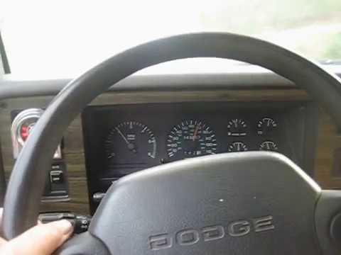

Some of the dakotas have 4 cyl motors and seem to get around OK on gasoline . With the V8 motor in the dakota on gasoline I consider to be over powered but on woodgas the motor is a good match with the weight and profile .

Hi joe happy easter,*truck looks like its purring rite along 55 mph,thats about all thats needed for me on big road unless driveing the big road through big citys in traffic hours, how did your temp hold back on the long trip, my rail entrance seem like it got a bit warmer last warm day i drove, about 300 f though i dont think i have any inturnal air leaks.?
Kevin, youâre right. 55 seems a good cruising speed. Going any faster most of the wood is used up both pushing through the air and creating heat. At 55 my temp outof the cyclone stays around 500F. I pushed it up to 70 once on a flat stretch but temp climbs to 600 and I donât like it. On the other hand the guage is right after the outlet of the tiny cyclone and the gas left the dump only a second earlier. I guess it would be like meassuring shortly after the crossover on a WK.
