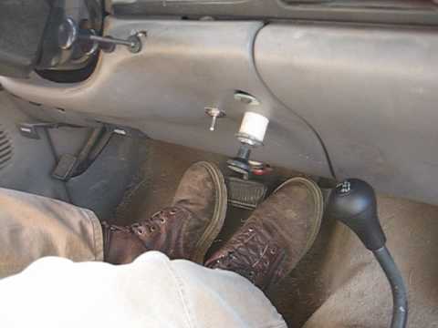

Hello Mr. Bob
Yes I will get some video showing the driving and controls.
Meanwhile below is a video I made for Doug Drost just this morning showing killing the overdrive in some situations
BBB :grinning:
Thank you Wayne, that was a big help. I hope some of the other members will do the same. Being able to watch the fuel/air ratio and seeing you shift in and out of overdrive, speed up and letting off the gas pedal and what speed you are traveling at, as you are talking through it all, was all very helpful to me. I need to change my driving habits to get more wood per mile out of my truck. SWEM
Thanks Wayne. Nice to see how to avoid gasoline hybriding when not passing another vehicle but needing a little power assist. I lack all those hills in this flat land area, but accelerating on an on ramp to get up some speed will be a useful time to use that handy method.

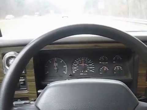

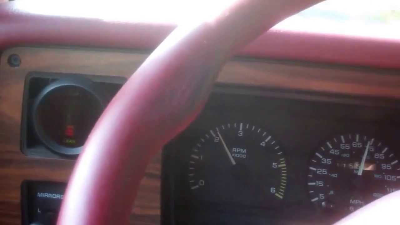

Good morning Mr. Bob.
See if this video of the air / fuel ratio gauge was kinda what you were asking for .
On the trip I made two slight adjustments to fine tune .

Thanks for the smooth ride, Wayne. Feels just like sitting behind the wheel. I sure wish we had some Dakotas here.

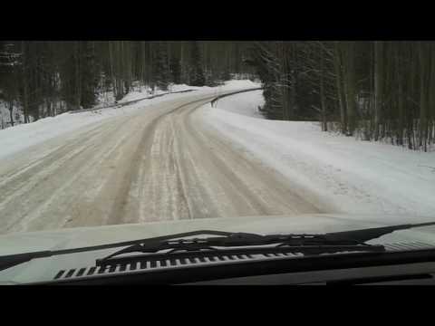

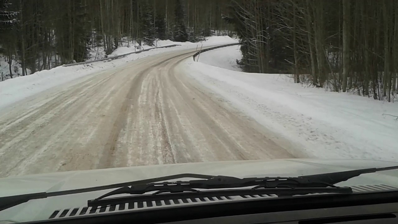

To all of you,
I hope you don’t mind ratteling around in a Rabbit for a minute.
I wanted to show something I don’t do very often - hybriding.
However driving big roads in high speed, climbing hills without loosing speed or fast accelerations are when you might want to add some gasoline with a tiny system (and a tiny engine).
As I have said before, after just about every ride in my woodtruck I think of things I want to change. It took me a while to understand how the guys were converting their truck to high bread with the trailer brake system. Since I have mine hooked up, that is the best thing I have done. With the gear ratio in my truck, it is normally slow getting up to speed. It is even worse with woodgas. So now just a little petro and I’m off with the big boys. TomC ( always fun riding with you JO. I was hanging on to the arm of my chair, because the road there looked a little slippery.)
Tom, I don’t know what year your truck is, but most vehicles late years enough to have a lambda sensor can hybrid without using a reostat. I rely totally on the lambda and only use a fuel pump switch. More air means more gasoline is added automaticly and the other way around. Gives a perfect a/f ratio at all times. But I like the off-position best :smile:

Thank you JO, that was impressive on how you can switch back and forth from woodgas to Dino and back again with the rabbit truck. Thanks again for great ride in your wonderful winter land you live in. You drive down the road as though you are on dry pavement. I just keep learning more every time I’m on this DOW site. SWEM

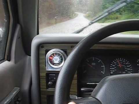

Hello Mr. Tom
What JO said .
I always hybrid with the computer handling the mix
Here are a couple of 4 year old videos

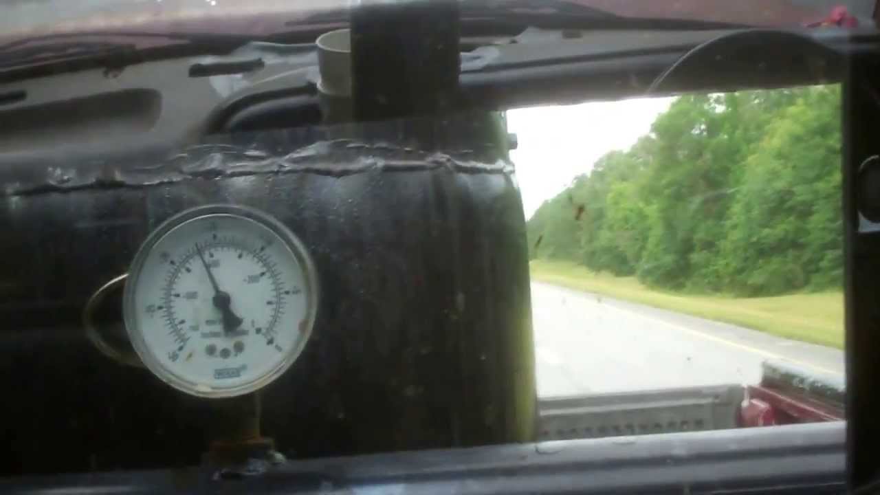

Good morning Kevin .
I use the rheostat switch when I need just a little boost of gasoline . Works very well starting the gasifier . The rheostat switch will allow me to gently add just enough gasoline as needed and wean back the gasoline gently as the gasifier produces more gas .
This video shows dialing the gasoline back to 0.

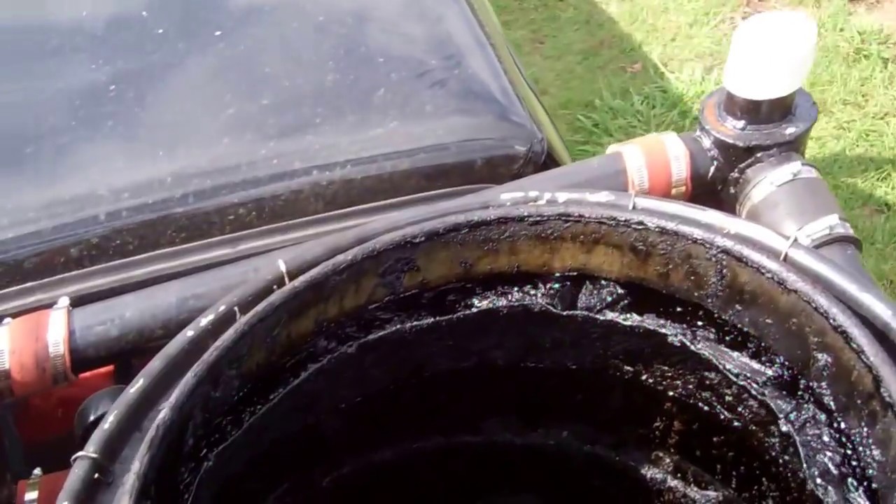

Example of using rheostat switch controlling fuel pump for starting
