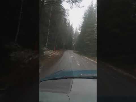

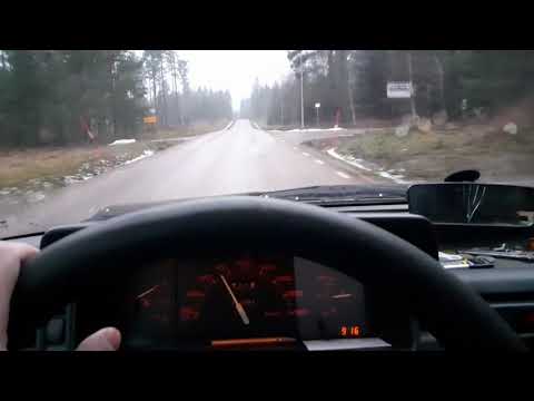

Tried without cone today when I came home from the hospital, (wife was on examination).
It works much better without cone, but not good, I have to shake the car sometimes, the signal heard in the film says it is too hot, got a little in a hurry then.
Thanks for the ride along. BBB
Yes thanks for the ride. Can you give us a little explanation of what is going on as you driveâ such as your speed and rpmâs, what gear you are in and particularly what rpmâs you are at when shifting. Is there some way you can record the sound of the engine? Maybe the vacuum and at what location the reading comes from. Same with temperatures. Donât know how you are holding the camera, but if you could, move it around to the gagesâ maybe have your wife video the gages while you go through the gears or make air and distributor adjustments.

Second video is just another arrend from yesterday. BBB.
Thanks for the rides. Do you have three hands - one for the steering wheel, one for the shift handle and one for the camera?

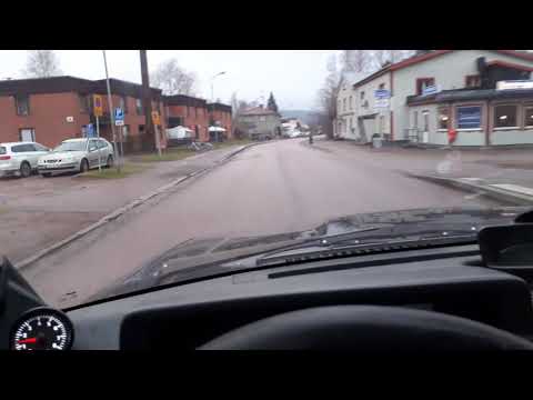

JO, In the second video I got a few glimpse of your speedo. Looks like you run about 30 k/hr. Is that right? TomC

I have a phone and film with, so it will not be so good.
The car has an automatic transmission, so the change takes place between 2300 and 2500 in the usual way.
I do not have a vaccine watch, the only meter I have is in the wood container, so I will see when it runs out.
The distributor can hardly be moved, is too tight against the engine, I have destroyed a bracket, so I can adjust it about 1/4 ", and stuck it in that position.
Insulation, is probably not wrong, see that if I try to drive with higher rpm, the car will go better (faster and stronger) but I prefer a rpm around 2000, which means about 80kmh.

What you saw was 80km/h. Close to 50 mph. Itâs the most comfortable speed cruzing along backroads with this truck. Just over 2000rpm, no vibrations and a relativly light load on the gasifier.
