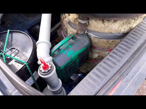

I must say that is a lot of water you are pulling out of your wood you are using. And this is good. Your Gasifier build is doing a great job on extraction of extra water. Congratulations to you the builder.
The back water and I saw some charcoal coming out of the back condensation tank looks normal. The hopper/tar condensation tank water nice and clear, it is doing a good job of separation of tar and water. Hay filter water I expected more because of what came out of your front sling shot front water traps. They are working great also.
In the morning fueling up and finding the collapsing of charcoal in the fire tube. Try this after shutting down the gasifer for the day. Open your hopper and check your charbed by using your poker rod. If it is running real lose it will collapse down alittle. Rod it and then close the lid. Make sure your intake valve is air tight and gas valves up front in the engine compartment are closed. Make sure all water drain valves are closed. Donāt leave anything open over night. It will cause your charbed to burn up. Air tight at shut down for the night.
I open my Hayfilter drain valve to see how much water would drain off the hay one time it was a cold freezing night. I lost my charbed. That small opening was just enough air to keep it burning all night.
I could hardy believe it but facts are facts and prove of it. Everything is looking good.
