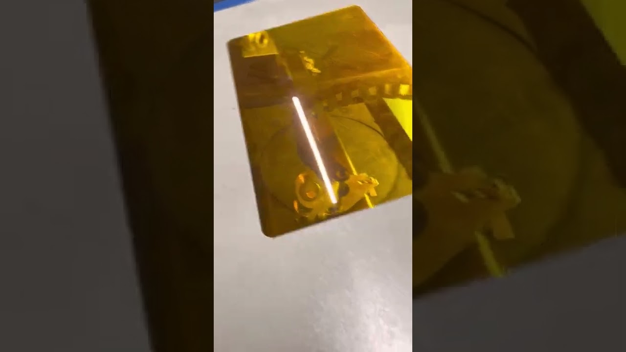

A few months ago I was able to put my hand on a K40 laser. Cheap chinese one but it works ok and there is work for it. Most important things first of course :grinning: I tried to cut a EPDM flange and found out right away that the machine is to small :frowning_face: Anyway , worked good and it gave me some time to show other unfinished projects.

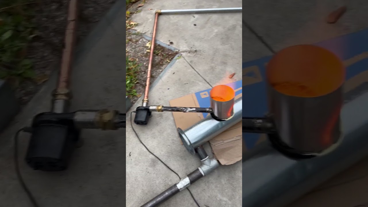

EPDM flange for scrubber/heat exchanger. Another pipe on top for the scrubber action. Inside this pipe a solar tube 10m long. To be continued, some day.
Making of the coil. A friend of mine machined the holder from some piece of HDPE. I dont own a cnc mill (yet).

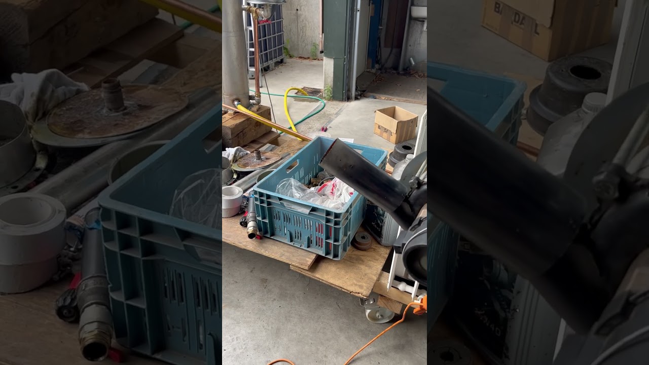

Finally a sunday to play. My wife calked me Tesla. Totally wrong. I came in like this tonight.
That why I am not that clever. Tesla fixes all in his head. So far everything the same, but in real life?
Anyways, had some fun, made a lot of mistakes, learned a lot and improvised more then the last three months​:grinning_face:.
Last time a strong flare, now I cant hold it. Mmm, slow slow
