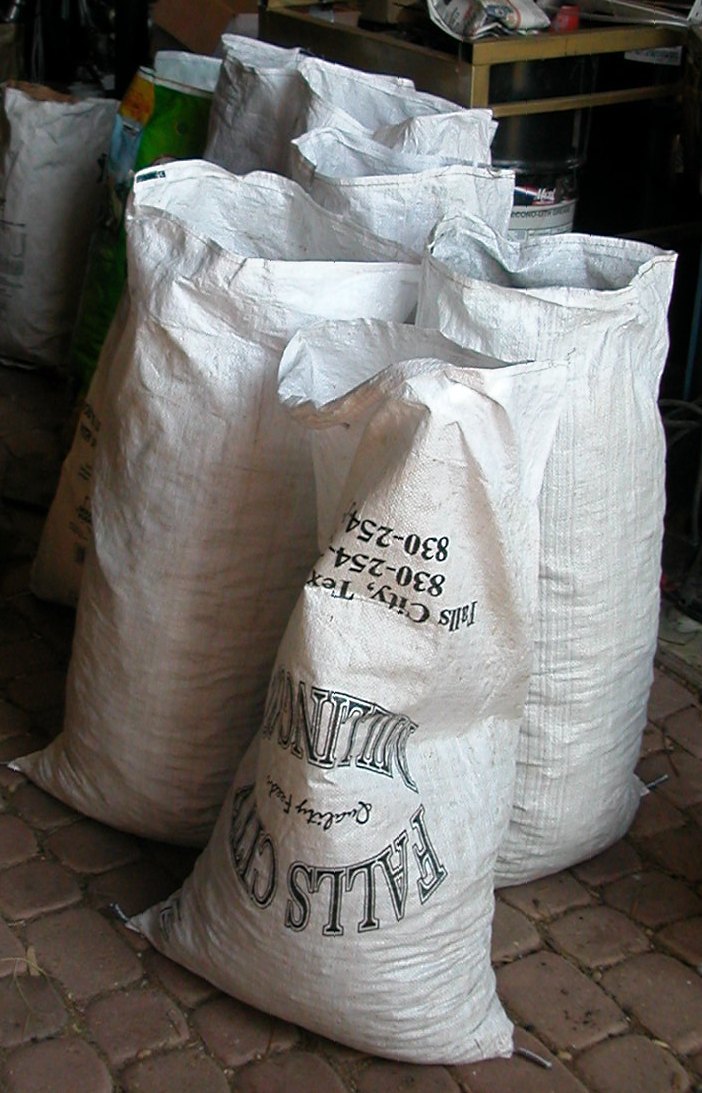

Cory, making charcoal must be like panning for gold. Just can’t stop! I’ve run 184 fifty-five gallon barrel retorts full, make it in a TLUD cook stove, and collect it from my wood stove ashes. One neighbor lady even sifted some charcoal out of another neighbor’s slash pile and delivered it to me. At first, I struggled to get the retort barrel sealed so the larger pieces of wood could cook into charcoal, by putting a 75# plate steel piece on top with several hundred pounds more of bricks and logs. I sealed the lower holes with clay and sometimes I would come out in the morning and feel the side of the barrel to find that it was hot, and burning up my precious charcoal. So I started dousing it with about 30 gallons of rain water, and raking it out on old tin roofing, and almost the same day, transporting it to a hardware cloth covered frame over a wheelbarrow. Use a little brush that comes with a dustpan and rub the fine stuff through the screen while looking very critically at the wood for any sign of brown, or stick shaped pieces, or nails, or absolutely anything that is not really well cooked. Save this for cooking, but get it out of your screened charcoal. Try to break any pieces larger than an inch with your gloved fingers. Look inside. Is it done? Now leave this on the screen for several hours in the hot sun. The next step is to reduce all of it to a size of 1/8" to 3/4". I use a copy of Gary’s charcoal grinder. Put the ground stuff back on the screen and look for any “brown” or nails or stones. Run it back and forth with the brush, then use the dust pan to transfer it to large trays (like they use in restaurants for collecting dishes). Leave it out in the sun, and then move it to a sealed drum. After a while, open the drum lid and see if there is condensation on the bottom of the lid. If so, it is not yet dry. If we have a low humidity day, say 10 to 15% RH, I will open all the sealed barrels and check, and leave the lids off for a few hours. We just had some 86 F degree days (late January) and today is a burn ban because the humidity is in the low teens. The charcoal needs to be small for use in the Simple-Fire. Small sized charcoal will dry quickly. One problem I have had several times now is having a pile of charcoal waiting to be screened catch on fire from an flying ember from a barrel being processed. Also, do not use stainless steel bowls to hold charcoal. The doused charcoal while “drying” will ignite in the bowl, and catches the grass on fire under the bowl, and burns the content of the bowl to ash. Most of my stored charcoal still needs to be ground in the charcoal grinder, and it
is stored in large feed sacks with a slip of white cardboard showing the date and type of wood. Some of the tags show the weight when the bag was loaded. After 4 or 5 years, they weigh less, indicating that water has evaporated.
