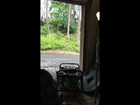

So close, yet so far. I fixed several leaks and it did improve but still couldn’t get it to run normally. Harder than expected to get this little generator to run from this big gasifier. I’ll be trying a few other things and keep you posted.
Hi Greg , what a shame like you say so very close , if i can just throw a few things out there and ramble on , in the video while it was trying to run up to speed i didnt see you trying to change the mixture valve is that correct or is it my bad eye sight ? as a lot of the time there is one position for easy starting ( sweet spot ) and another for ramping up to speed and making power .
If when on petrol the generator runs normal we can rule out mechanical problems with the engine and so my gut feeling still tells me its weak gas , when you blew back through your system did you also spray soapy water around on the carb and the fitting ?
Another way of testing that would be to run the engine up again on charcoal gas and while its trying to start spray some starter fluid onto the carb and see if the engine stops .

Hi Dave, I didn’t change the mixture valve while it was trying to get up to speed because I had done that several times before, and it got worse whether I went up or down. But in some cases, I did notice it improve from the starting position. The valve is way too big, so I’ll be installing a smaller valve before I try it next.
It does seem to run OK on propane, but it doesn’t seem to handle quite as many watts (2800 running watts) as it is supposed to. I should do a more precise load check on propane, to confirm engine is good.
