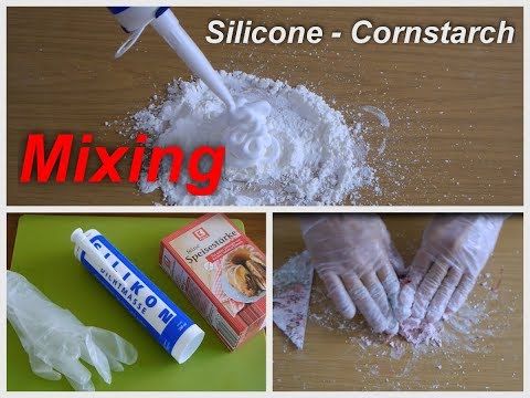

Hi Greg, mixing high temp RTV silicone with corn starch makes a excelent gasket and it cures fast as wel. I use this method allot
Armand, Can you say some more about the RTV/cornstarch gasket? does the cornstarch make the silicone spongy? Do you mix in as much as you can, use equal parts or have some other method?
The mixture doesnt get spongy at all, it turns into a hard rubber, i usualy just mix enough starch so that the silicone gets to a play dough consistancy. I dont have an exact mixing ratio, but you realy dont use allot of starch.
OK, I get it. You are making high-temp gasket putty. That is a good idea. I bought some expired date red silicone putty and I have used a lot of it it for gaskets and sealing leaks. I also have some spongy sheets and strips that have been useful.
