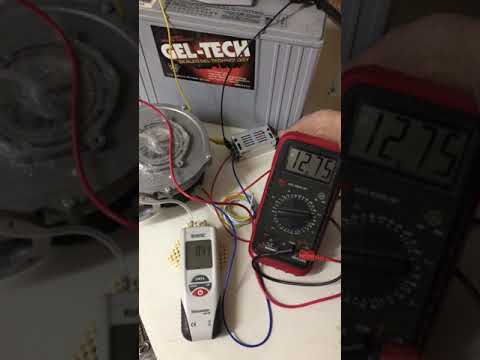

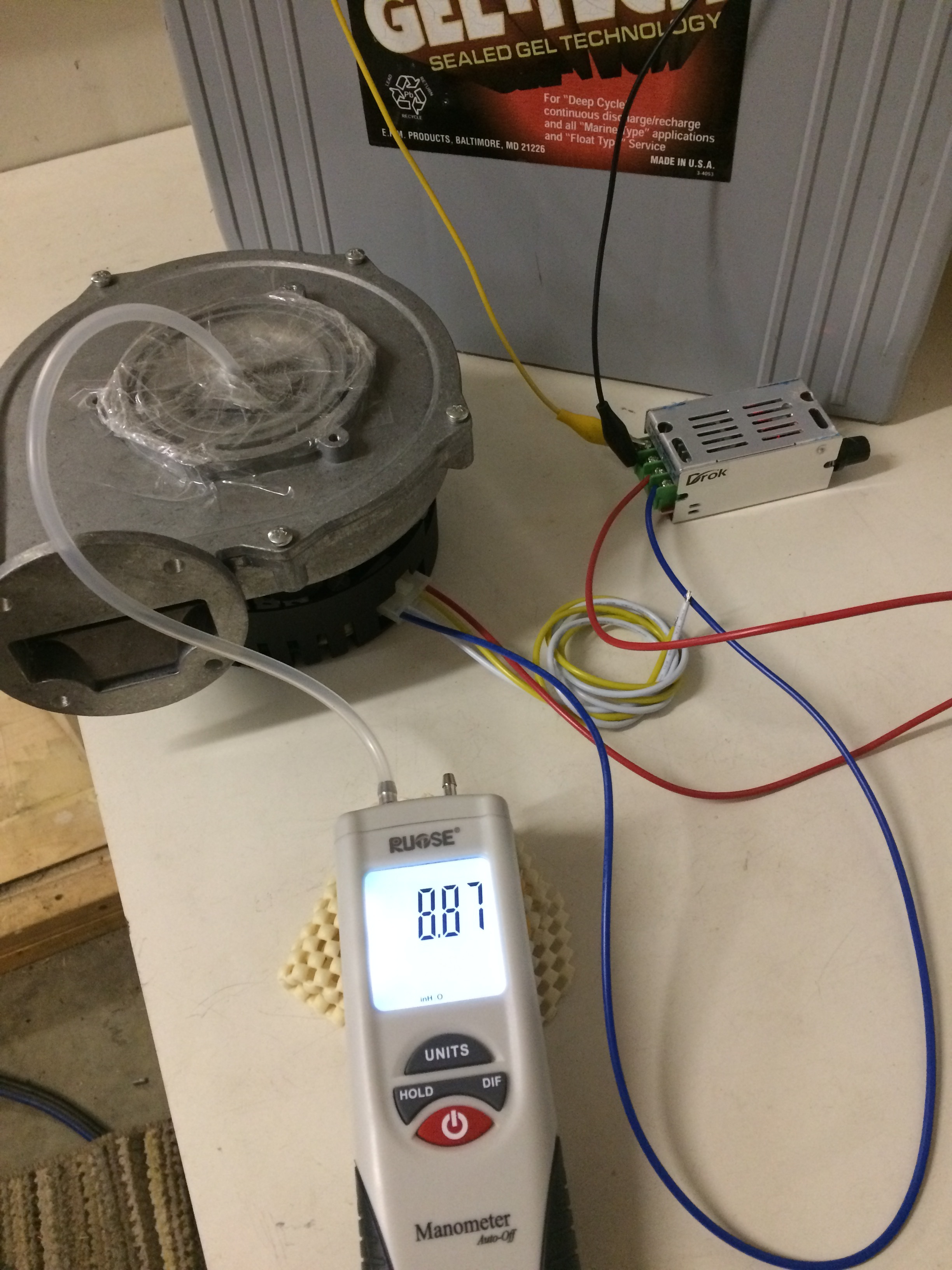

You show powering this 12vdc blower from a battery. What was your supply battery voltage under a blower pulled down load?
Discharged battery voltage under a light load will be 12.25 volts. Fully charged 12 vdc battery lightly loaded will maintain 12.62 volts.
Yep. Full to empty on lead-acid batteries is measured in hundredths a of volt, within a less than a one volt range.

@SteveUnruh Good news - You’re right! I got a bigger battery and made sure it was fully charged and the blower maintained about 8.50 inches of pressure. The highest it got, at the very beginning, was 8.87 inches.
Too bad that battery is way too big to put on my gasifier. I’m hoping I won’t need to use it. I’ll be firing it up for the first time soon - I’m waiting for a kiln thermocouple so I can monitor the temperature inside.

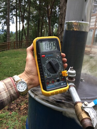

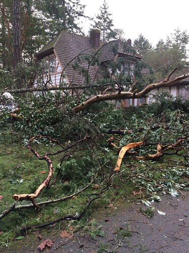

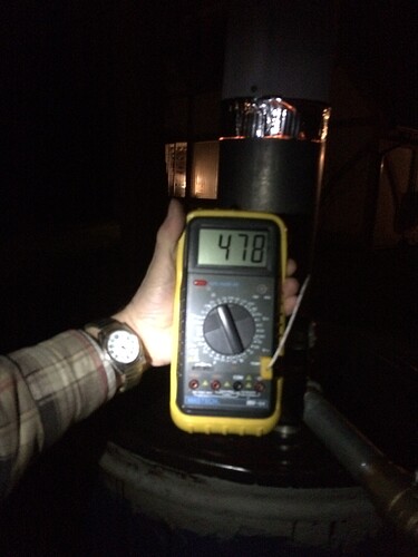

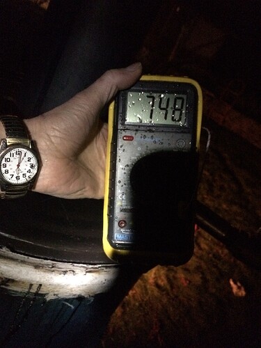

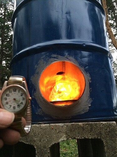

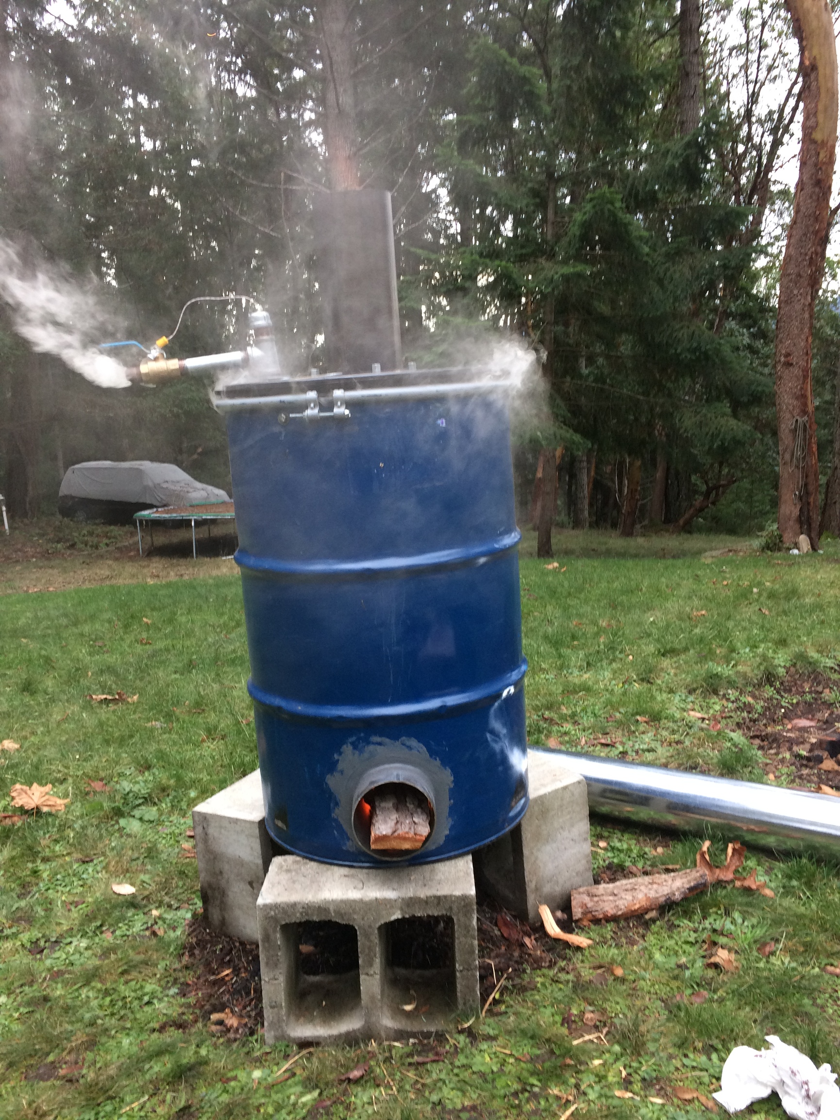

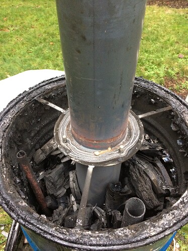

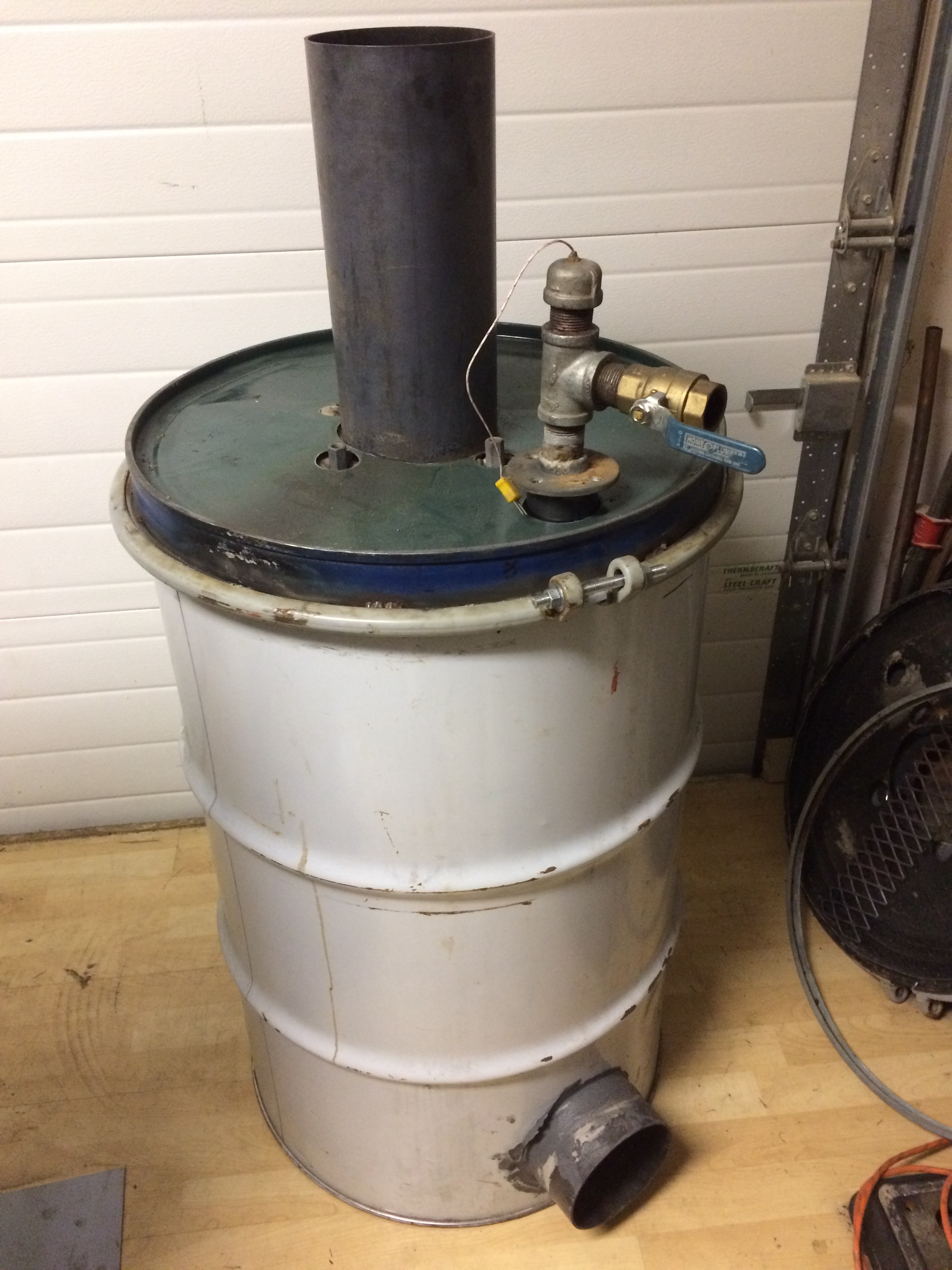

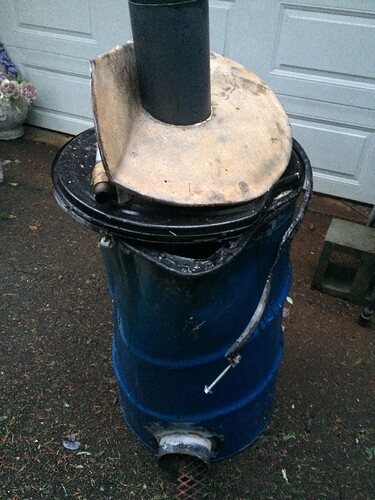

Yes, Dave, I ran a batch of seasoned fir in the retort about 2 weeks ago. I had a thermocouple running down through the vent into the forming charcoal, so I was able to take several temperature readings, which got up to over 700 degrees C. I was able to see the intense fire from various gases released from the wood, that were forced down into the fire tube. I had to quit early because I was afraid the high wind would blow the sparks into the trees and start a fire, even though there was quite a fine mesh over the chimney. But still the product was about 70% good charcoal. The sad part came a few days later when a real serious wind storm blew down a 85 foot fir tree which seriously damaged the retort as it slammed into the ground. So now I plan to salvage the undamaged fire tube and the repair the inner barrel/insulation layer. I’ll need to get a completely new outer barrel and top.
There were a few things I learned:
Lots of smoke escapes through the crack under the rim of the lid. It is held tight by the metal band but leaks smoke unless it is really tight. I crammed a lot of furnace cement in the crack this time but next time I’ll use a fire-rope gasket.
Don’t try this if it is real windy. I decided to shorten the chimney from about 6 feet to about 3.5 feet because the chimney almost blew over.
For easier internal temperature readings, I need some way to hold up the meter.
Wear gloves when handling charcoal.
Don’t put too much wood in the fire tube or it plugs it up and the air can’t roar through.

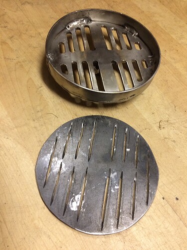

Hi Greg , My thoughts for what they are worth , if you are making charcoal for start up of the BP wood gasifier then i would just load with larger size chunks of charcoal and then once lit fill with your normal size wood chunks , i think if you alter the size of the grate down in size then my thinking is it will need a lot of shaking to keep the flow going , BP made that size grate for a reason so it would not choke up so easy .
If on the other hand you are going to try running it as a charcoal Gasifier then i will be interested to see how your grate holds up .
Nice retort by the way, looks like pro job
Hi Dave, I want to run it on charcoal, so I guess I’ll just try it with the 1/8" slots and post my results.
