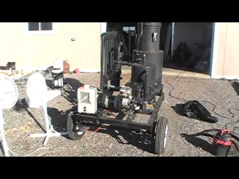

First run after some cleaning and re plumbing
second hopper fill since it’s major clean out and re plumbing.
I had a bit of trouble with plugging as i used the char my friend TerryL left for me in Jan. but didn’t shake out any of the really fine stuff. Didn’t take long to sort it out…
Couldn’t find the battery so I couldn’t use the electric start on the genset. 3 pulls and it was running as per usual.

Good job Arv, I counted only 2 pulls to start!
I started looking at the yesterday Steve… I’ll continue to look it over… it does give me ideas that’s for sure…
Yeah Don, can’t find the battery so I had to hand crank it… took 3 pulls the first time…
How sweet it is !!
BBB
disappoint this morning… it two pulls to get the genset running…

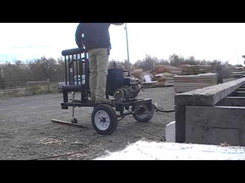

Here’s me checking the feedstock level on the lil gasser… file size is 19Mb

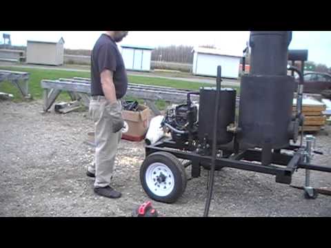

Ok. so i’m a jerk… started our little unit on the left over pellets that were in it… flared really nice, almost right away. Now loaded up the hopper with some pretty big blocks… we’ll see how long it runs like that. 229 hrs on the tiny tach.

well, it did run for about an hour… i suspect it used up all it’s char trying to make more and then put itself out… i’ll know more tomorrow morning when i clean out what’s left and see for myself in person…

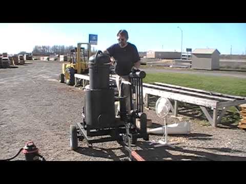

so i cleaned out the blocks… they were really too big… oh well. added more char, the stuff TerryL left me, but this time i screened it first. it lit right up. loaded 40lbs of pellets and it started after 2 pulls… I flared it first for a couple of minutes… we’ll see how long this runs till it stops.
So it ran for just over 5 hrs… most of it with a 1500 watt load, but some of it was with 2250 watts. I did have a couple of stops and i’m not totally sure why… I think Billy cutting steel panel and using the genset (load/ no load) may have had something to do with the first time.
Lots of condensate in the cooler… it having snowed some and being very wet out may have some to do with that. really time to work on an auto mixer… we’ll see what happens next.
