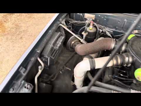

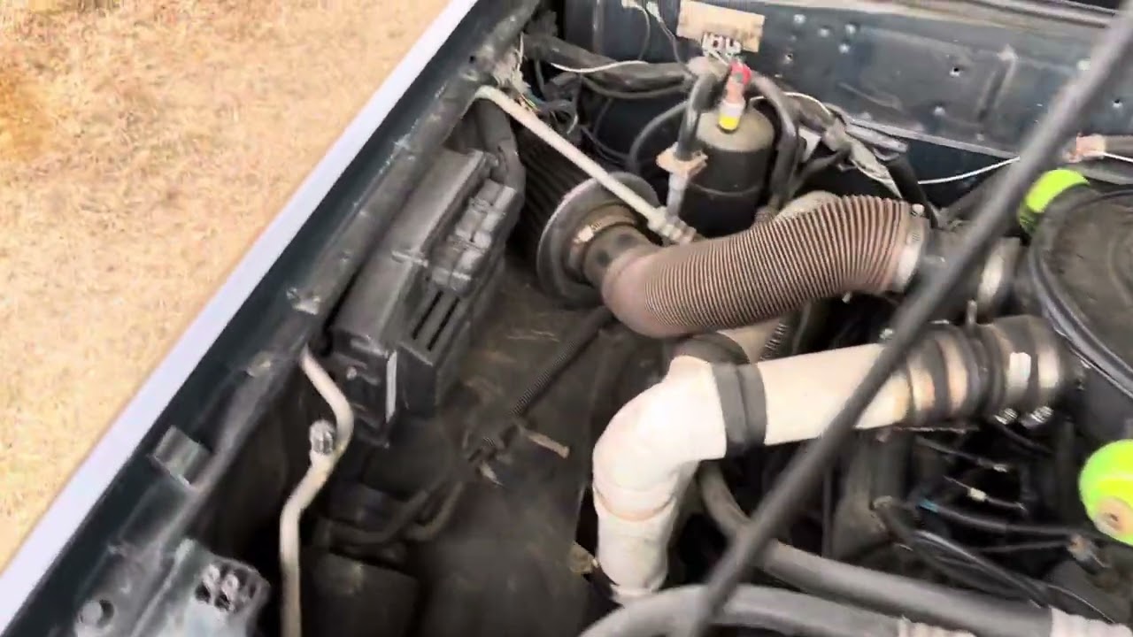

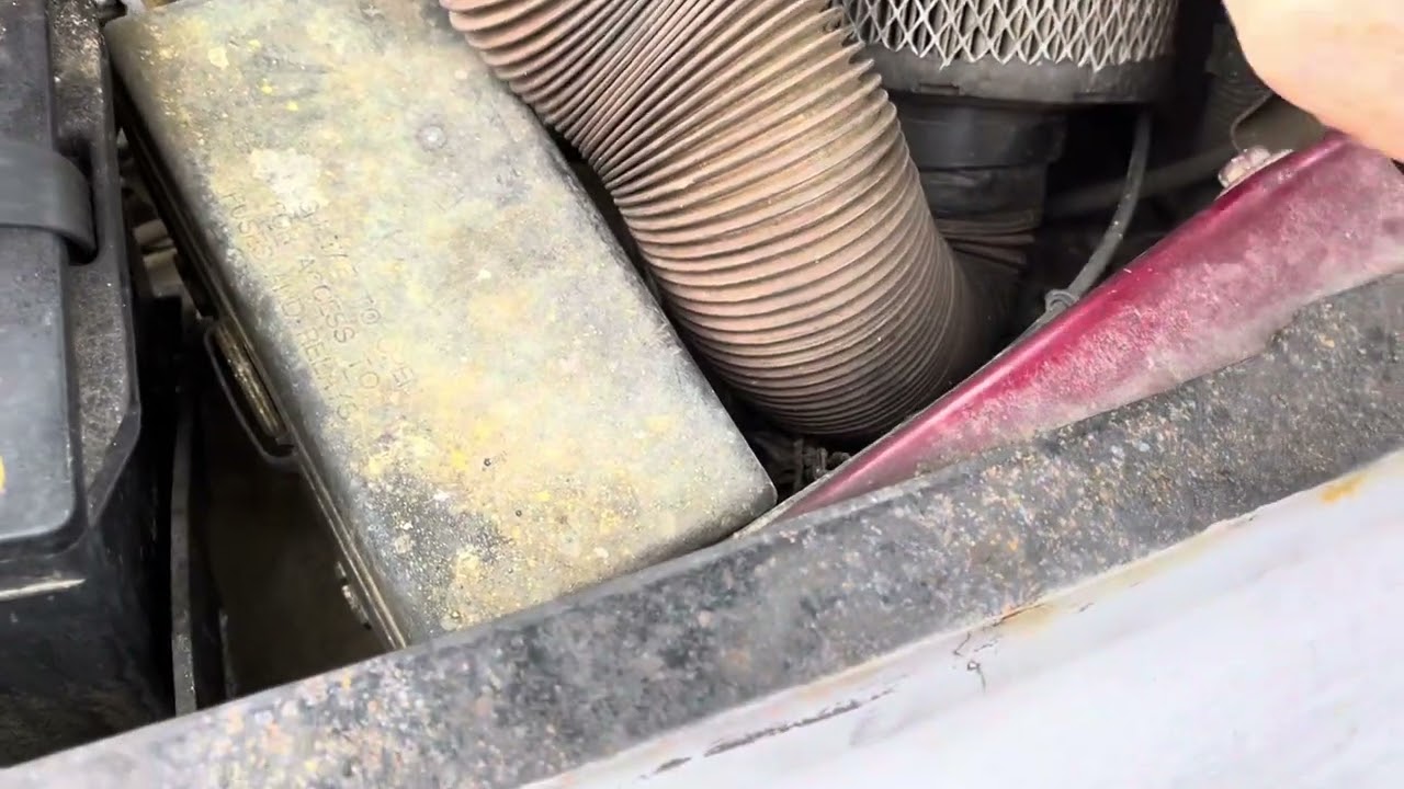

Thanks Wayne… I’m slowly realizing there’s a lot about trucks I still need to learn, incl MPFI. So I will be on the lookout for my NEXT gasifier project: V10-MPFI. What make/model/year fits that bill the best? In the mean-time, I shall continue with the Dakota. I’m modifying the air cleaner now. What air filters do you recommend for the 2 air inlets? A dedicated filter for each? Mounted where? I intend to swap out the stock air cleaner first in order to get the truck running on 2 dedicated inlets, before installing the 2 woodgas inlets. And then complete the plumbing… pics forthcoming :slight_smile:
I made a couple videos of the above details you were asking about but having trouble loading up to youtube . I may have to wait until my Son can help.

Wayne thx for the vids… was thinking the same - nice to get confirmation :slight_smile:
