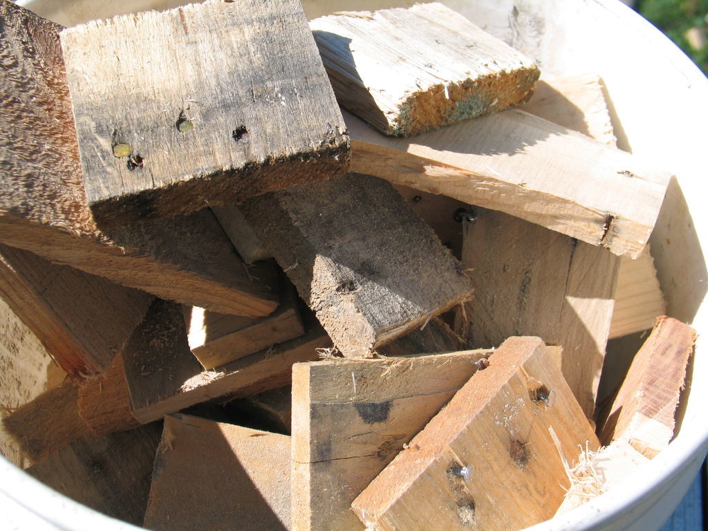

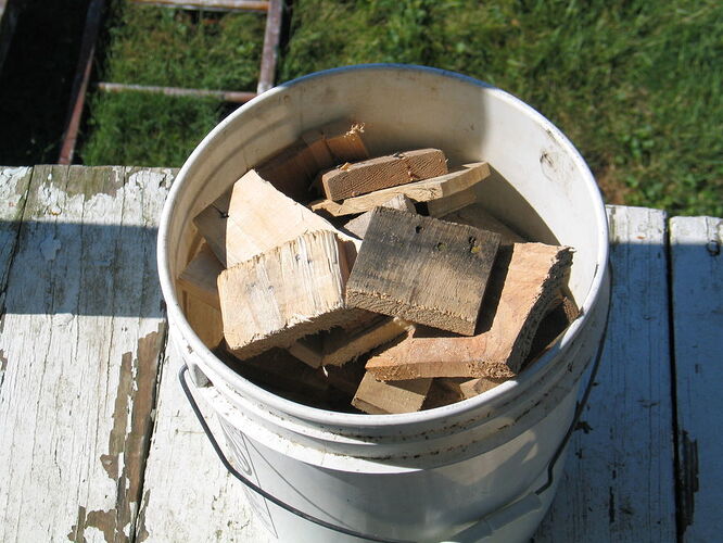

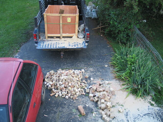

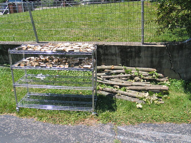

First I noticed that our next door neighbor had a tree down in a recent storm. He was out there with a chainsaw cutting up limbs, and I offered to take some of it off his hands. He was happy to be rid of it, and I had some nice fuel - all that I needed was to slice it up on the table saw and dry it. Table saw part works OK, but slow - then I had little rounds of wet wood, which if I want to burn them anytime soon I needed to split in half. So that was time consuming. And so the first picture is the results of about 30 minutes work - barely enough to get me to Walmart and back.

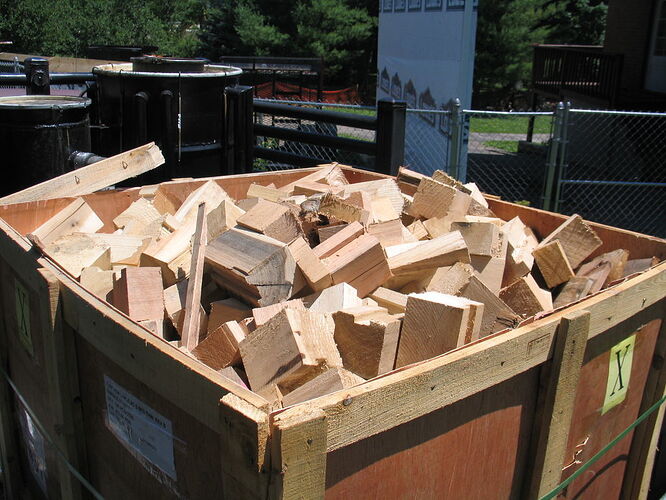

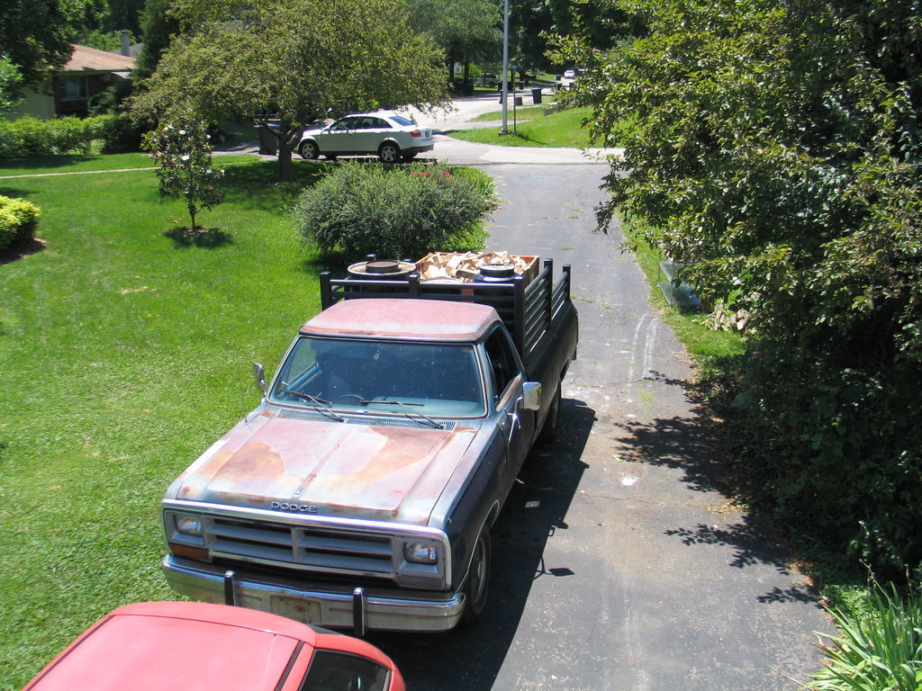

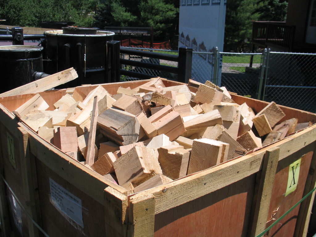

So then I did what I should have done - Googled for “truss manufacturer Frankfort”, and “pallet manufacturer Frankfort”. Both these are universal enough that I felt like I had a good chance. Sure enough, it turns out there’s a pallet reconditioning place about 5 miles from me. I emailed them and asked about scraps - they said come get as many boxes as you want! “Boxes” being unclear to me, it still sounded like a good shot. So I went over there and this is what they loaded on the truck - ONE box. The size of a large pallet. I don’t think two would have fit in the truck.

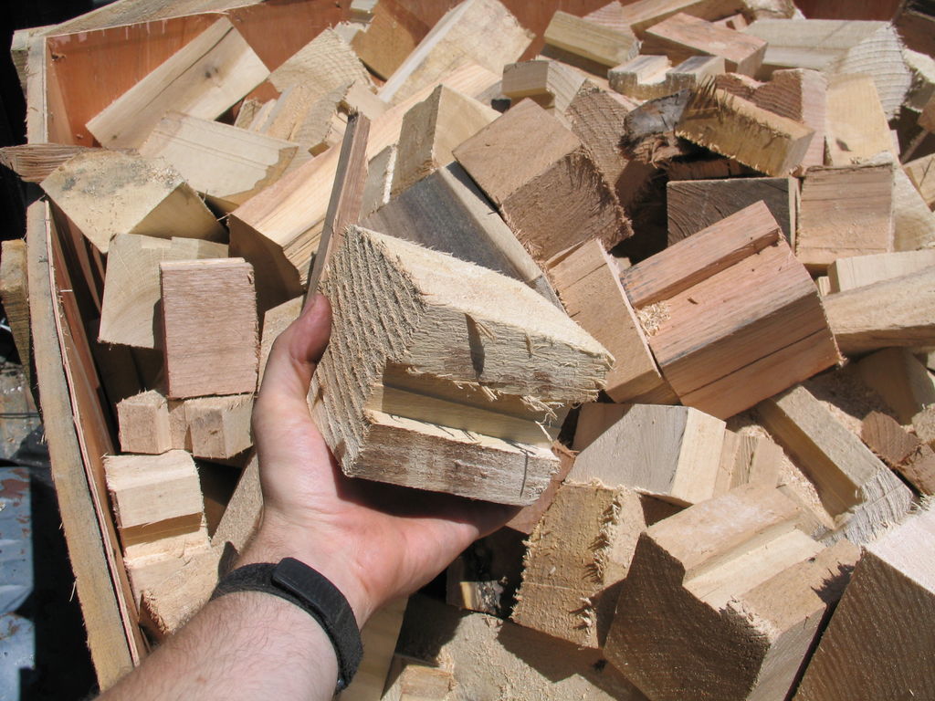

They said there’s no nails in it. It’s dry and ready to burn. The wood is on the big side but I can split or saw a bit if needed. Or run slightly bigger wood than I’m used to. Anyhow, it’s not bad for free and will certainly tide me over till I get a chunker built!

Update on the wood, seems to be mostly poplar with some red oak. A lot of too long pieces, around a foot long. I am splitting these and will buzz them in half with the table saw. Also there are some pieces with nail heads in them (cut off from the pallet), so I am sorting those out.

OK, the miter saw works great! Cut like butter. Making me think the table saw blade is dull, which it probably is… It cut up the pallet wood so well that I realized something important - the wood is NOT dry, it is still green. It’s light because it’s poplar, but it’s not dry. So my immediate fuel supply is now very low… but there’s a lot coming soon.

Progress ended for today… I’m about halfway through the box, and I think I’ve got all the big pieces out. Mostly little nail filled scraps left. Pile on left is finished and ready for drying. On right are approx. 4" cubes.

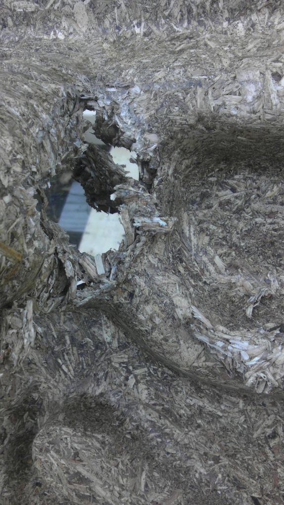

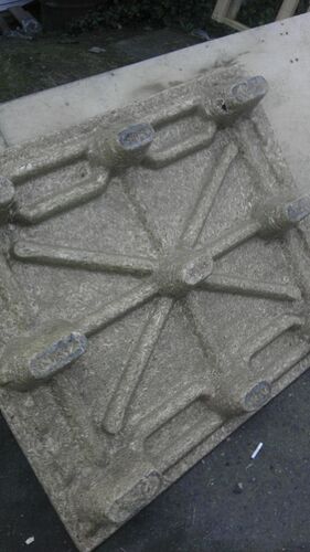

I found a place that uses these funky wood pallets that look like the are like a flattened “pressed-o-log”/cast OSB board. I don’t think they are glued together. I snapped some pictures with my phone. Would these be usable as fuel or should I avoid them?
Ick. From what I’ve experienced with those they are really made from pressed paper and will dissolve when wet. The reason they didn’t need glue is because paper will clump up when wet. As it will in your gasifier. Also most papers have a high clay percentage for smoothness. Meaning a lot of ash.
Might be able to run a little of that with a lot of wood. But I wouldn’t use it alone.
Those were out in the rain and didn’t melt, nor are they made from paper (at least the ones I saw). Its a very course saw-dust/wood chip mixture as far as I can tell. Look at the close-up of the hole that got torn in it.
