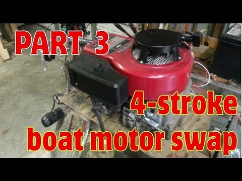

I’ve done a 4-stroke conversion of an old evinrude:
I have not attempted to run it on gasifier, but it is 4-stroke so it certainly could be run that way.
There was some genius in there somewhere Dan. Maybe it was thinking about doing it or for sure casing the adaptor. It even made a pretty good wake. I’m surprise that anyone thinks having a pressurized tank full of gasoline is safer than having a gasifier on a boat. I think BillS had the right idea about the pontoon boat.
