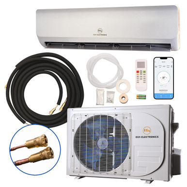

I’ll just add to this. Overpaneling is cheap power. Buy more panels, they’re cheap. You can use the extra solar panels to reduce your battery needs, if you find ways to load shift. Don’t ask batteries to drive resistive heat loads or large motors if possible. The extra daytime solar can drive loads directly. For example, use some of your panels to directly run a DC mini split like this one, let it run when the sun shines:
