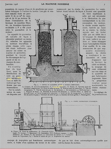

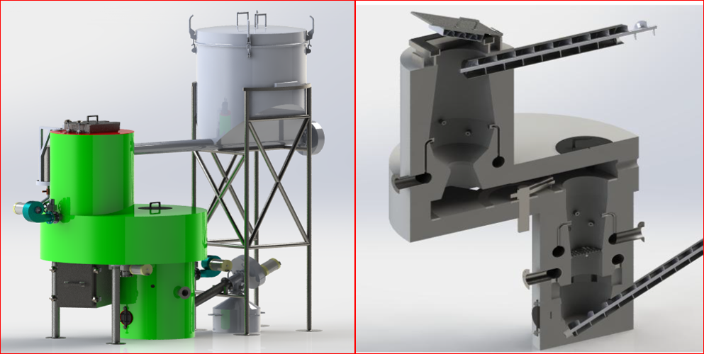

you can discover the gasifier of Mr. Henri Riché, in 1900, in France, it was the most efficient, and I disclose to you a modern autimatic version, the top container receives the pieces of wood and distils them, between the two containers, a pallet takes the reduction in charcoal, by the effect of the rotation of the pallet arm, drops the fines into an ashtray, so that after only coarse charcoal falls into the lower container, which will be treated at very high temperature on syngas of the first container, and thus obtain an efficient syngaas, also thanks to the concrete.
