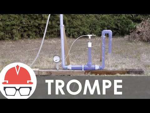

But l was researching trompes.
https://images.app.goo.gl/iYvaotou29tj14LR7
Having an unlimited supply of compressed air is good. It can be transported anywhere on the propperty, no matter the elevation of sorce, it can be stored and there are applications that require it anyway. Fishpond aeration, septic tank aeration, steel forging, and it can be made to power water pumps too. A trompe wuld provide air for it all without paying for electricity or listening to noisy air compressors.
This is some background to my thinking. Now, for why l put this in this topic.
Looking at some videos and diagrams, specialy the venturi part of the device, l realised it could be a extremely efficiant way to safely compress and purify woodgas! Imagine if we pull woodgas in the trompe collum instead of air. The water will draw on the gasifier, no blower needed. The gas contacts vast amounts of cold water wich will cool it imidiatly, no need for coolers. The dispersed bubbles will clean the gas and the pressure and cold water shuld even scrub most CO2. I think if one has a body of water nearby with a bit of head to power the trompe its a great solution.

Few things @KristijanL you probably should care of.
First, the pressure/volume performance. What I see is quite huge flow able to collect only a little air to blow off a chunk of straw. Do you think it is enough to draw gas from gasifier?
Second, the ecology. Do you think it is OK to let all scrubbed things go down the stream? I see this as a drawback also for the stationary gasometer. Once a time you will need to solve what to do with the solution.

Kamil, the trompe on the video is just a scaled down see trugh example. We talk about a machine with about a 10m drop, wich shuld produce up to 10 bars. And an actual venturi, not just some straws hot glued in a clear pipe.
The ecology. This one l was thinking about too. I realy cant say. I dont think good woodgas will be any problem. CO isnt realy soluble in water, tar and acids arent realy present and the only pollutant is a bit of soot and condensate that gets diluted a lot. But if we want to use updraft, or pyrolisis gas, thats a concern.
