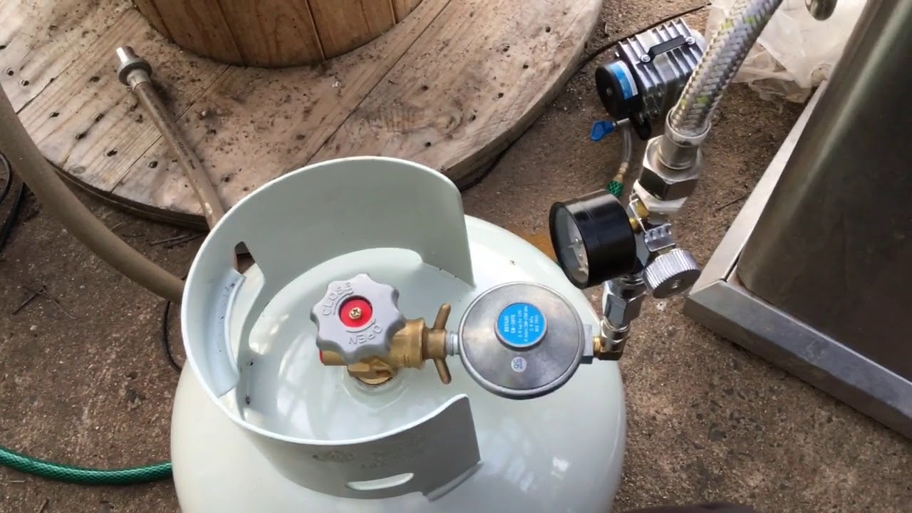

There a fella on YouTube down in Australia that set up a bio digester in a ibc tote, that vents into some sort of bag that when it fills up he compresses it into propane tanks, pretty neat thing. See if I can find it…
This is the guy. Not sure it is anything very useful to woodgas but still neat

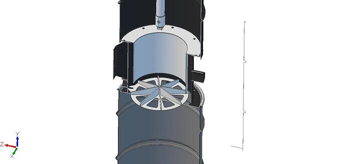

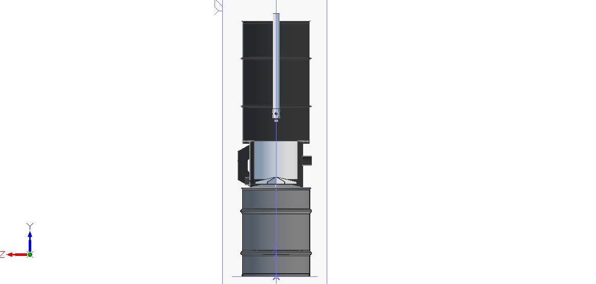

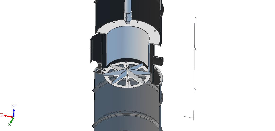

Ok so version 2. This one is a little more complex but still simple as far as a down draft gasifier goes. The nozzle is a 1 inch full pipe couple with (4) 1/2 inch holes drilled at its center. Then a pipe plug to seal off the bottom. Grate is very passive with gussets on the top side to help break up the charcoal. The support also has gussets to the top side the are under the grate. There are two main weldments. The reactor core and the reactor housing. The core is the center fire tube and this simply fits inside the housing. This creates an outer chamber for exiting gas to migrate out the exhaust port to the right of the model shown here.
I will need to design a lifting mechanism to lift the gasifier off of the catch barrel to exchange it. Ill more than likely integrate this directly into the gasometer infrastructure somehow. So a bit more complex but still cost effective to build. If i have time this next week Ill bang this thing out and use some barrels I have here at the shop.

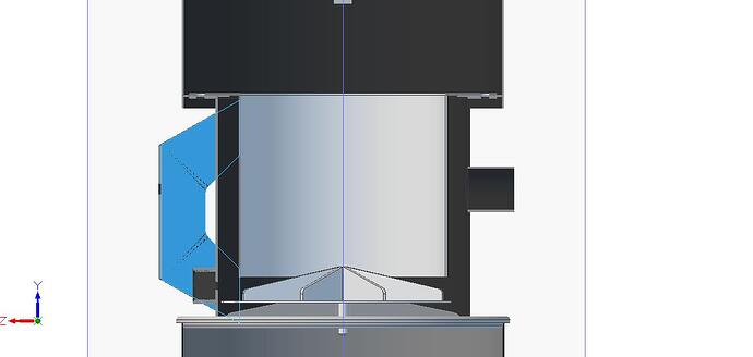

Note this blue highlight section is the motor mount bracket for the grate agitator.
