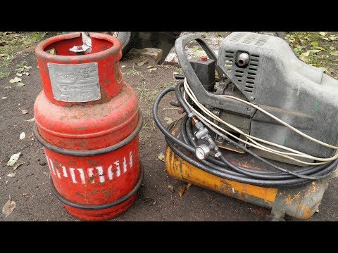

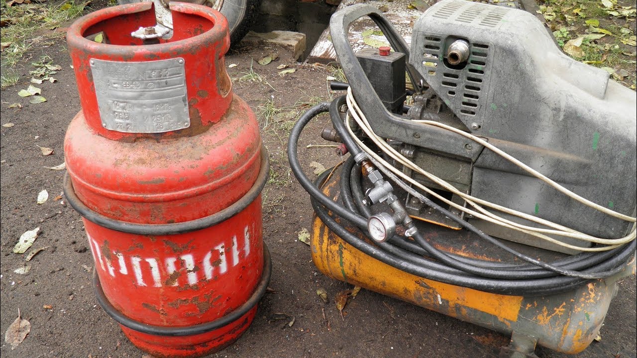

hello vladislav, we have seen some of your interesting films…very great, compliment…
unfortunately i dont know russian language for understand what you explain…
especially how you make fuel from old plastic and tires is very interesting for self sufficent life and times of crisis.
i think especially on chanin saw, i have seen in your films you use your self made fuel for it!!
make you also the oil for the mix by yourself?
also the chain oil?
have you a plan-design of your equipment so i could understand maybee better…
ciao giorgio
GiorgioP.

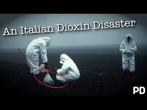

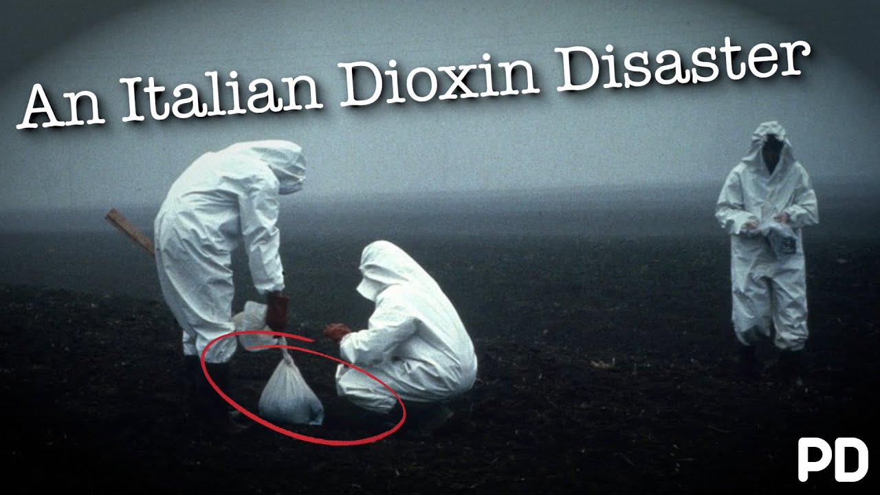

If I were you I would avoid that because of the risks involving fires explosions and toxic residue.
For example…
If there is PVC plastic in your reactor you will create vinyl chloride gas.
This is a well known toxic cancer causing gas that will escape your home brew systems into the environment.
If you try to deal with by flaring the gas you risk creating Dioxins, that are even more toxic.
An interesting video of an accident that release between 200g-1000g of Dioxin release.
Chlor-acne scarring caused by Dioxin poisoning on the president of Ukraine in the year after the Orange revolution.

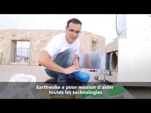

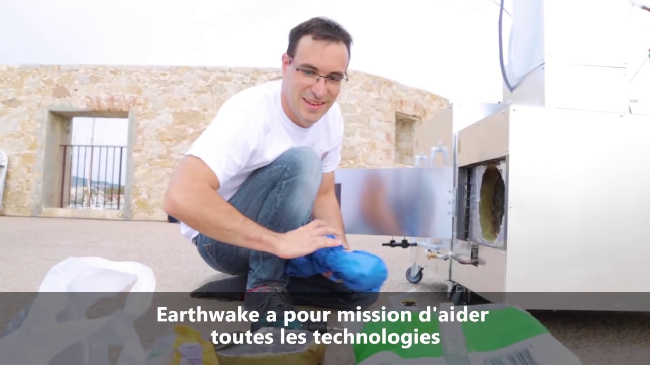

thanks, wallace, you are absolutely right…i think it depends also what type of plastic is used for this kind of destillation, i thought to get more knowledge and than build something simil like in the video from a french inventor - a closen system… i really not like to poison me, my neighbours nor the environment.
what do you think about this video??
ciao giorgio
I will have to listen more closely and try and understand.
De-Polymerization…
Using heat to break the bonds and return a cross linked polymer to a liquid.
You end up with the same sorts of chemicals used to make the plastic plus impurities.
Yes this will make flammable liquids but are they motor fuels?
I don’t know, I would not burn them in a car.
They might make good heating fuels provided you have complete combustion.
This is octane an alkane that is the correct range or size for gasoline. They may rate gasoline by iso-octane (can’t remember).
So with a bit of added heat, it’s possible to break enough ethylene bonds to make an alkane that resembles gasoline…either octane, iso-octane, heptane, iso-heptane, hexane, iso-hexane, benzene (or other alkenes), or heavy molecules 9,10,11 range.
