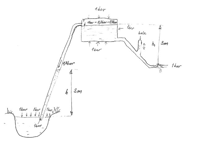

Some basic laws of hydraulics:
-Fluid is not compressible
-the liquid is not a rope or wire to be pulled
-liquid or gas can only be pushed
So if I draw another sketch of this situation, we see what pressure conditions are acting on the water … if anyone sees any additional force or pressure, please draw it.

Really excellent diagram picture Tone.
You show well a suction atmospheric weight pressure system.
However the original system of “Trumpe”? is using the weight and flowing energy of water.
Much more energy’s involved.

How do I push liquid up a straw to drink? I use suction which is drawning pulling a fluid by creating a vacuum on one end of the straw that is less then the atmospheric pressure in the glass of fluid. The atmospheric pressure is then pushing fluid up the straw until it runs out of fluid. Then the atmosphere is sucked up the straw. This causes the fluid to stop going up the straw unless more vacuum suction is applied and fluid.
I did not know drinking from a straw can be so complicated. Lol

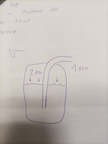

Bob, you clarifyed that your self. The athmospheric pressure does the work. In a way you just alow it to flow. Like opening a valve.
Imagine this. Its the same thing, same pressure difference as in a glass of water. Water flows, but there is no suction.
Yes, atmospheric pressure is a working force and suction or vacuum work together in a siphon. If you applied continuous water movement at the suction end this is more of a power source entering in. It is then possible to raise the water higher then the inlet of the pipe. The water is being pushed. Not just being siphoned by action.
This is what is done in a stream.
