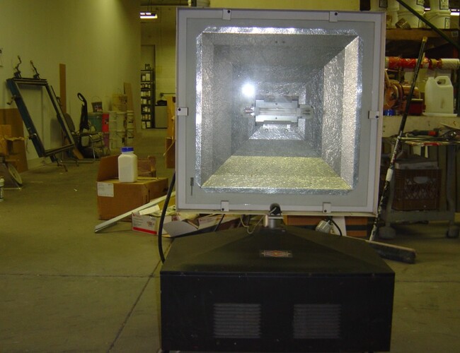

I used to have an old fashioned carbon arc light for making stencils for screen printing. That thing was a beast. 240vac 30 amp circuit. Weighed a couple hundred pounds. Cool to use, a little scary at times!!
This is the closest picture I could find quick.
It looked similar to this. This picture may not be of a carbon arc light, it is too clean!! same manufacturer.
