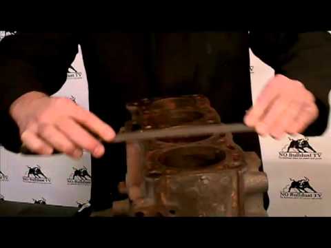

Machine work is such a pain in this town I think I will draw file the head down myself rather that try and find someone willing to mill it.
Vice work is a little slower but I can do this just as well by hand.
Never knew you could do that. I didn’t think you could get it accurate enough by hand. But alas, but here is a video on it… how do you keep the pressure even on the file?
You need a precision straight edge to check results, and a marking compound to verify evenness.
For heads a person should be able to use varying grits wet & dry sandpaper glued to granite tiles.

Lots of fellows over the years have done this sort of thing with the small or big block Honda.
Even using a belt sander to take the majority of the metal off and finishing up on a flat true surface.
If you have a local fellow that makes heads stones or stone counter tops a thick slab of that stone with some 320 grit sand paper you can true up a head on.
Not such good idea with a block to try and deck this way though.
I would be afraid of screwing that up.

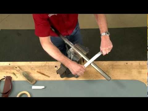

Useful video.
This man is using a technique from another gun smith who’s name eludes me right now.
There are few different schools of though on the best way to do this.
The pull method, or the way I was shown is to push.
But I hold my hands under the file with light pressure to try and avoid causing deflection in the file.
You probably can do it both ways equally well.
Today people do not treat a hand tool with the kind of respect they should.
Files should be kept clean and lightly oiled when not in use and never touch other hardened surfaces.
You shoudl clean them dry with contact cleaner before use and as done in the video chalk to help keep the teeth clear.
I think he uses way to much chalk and I honestly think he is not very familiar with this technique on how his hands are moving and and his claim this is slow.
The Gun smith I knew all those years ago could work up one hell of a sweet but turn a round barrel into an octagonal one faster than you could set up a mill to do the same work.
When you do this right and you have a good file you can turn steel into wire wool it flies off so fast.
Trick is to keep consistent pressure, check for flatness and keep you file clear.
