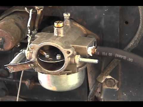

I have to make room in the shop and see exactly what I got myself into
This is not me or my video but it is almost identical.
