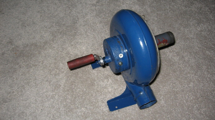

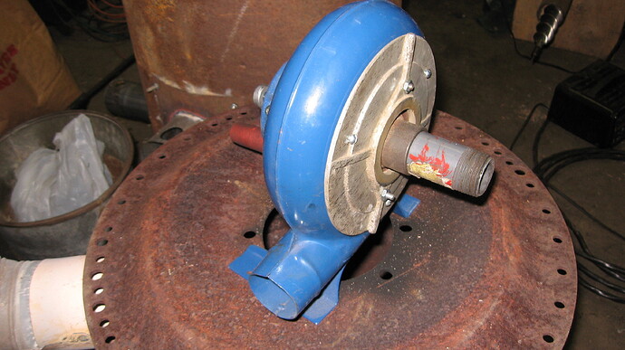

Thanks Gary, - it looks like it might be Chinese made so I think I’ll see if I can find a supplier in China who can sell one to me at a cheaper price.
Old thread I am jumping into but I noticed the hand blower myself in one of the videos that Gary Gilmore posted.
I followed his links to Ebay.
Then I saw this.
On the side of the blower is marked Rajkot.
I know this place, its a major centre for small engine production in India.
I am told there are 200 small foundries in the city.
Some of you heard of Listeroids made in India?
Most of these come from the Rajkot area.
